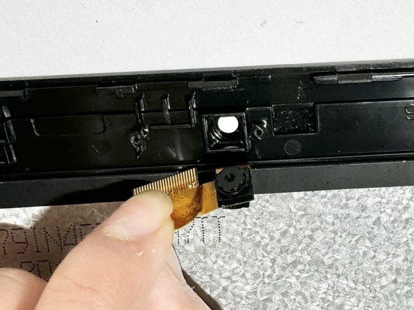

  7. RCA 8 Apollo Camera Replacement, Camera: crwdns2935265:07crwdnd2935265:01crwdnd2935265:02crwdne2935265:0 RCA 8 Apollo Camera Replacement, Camera: crwdns2935265:07crwdnd2935265:02crwdnd2935265:02crwdne2935265:0
    • Remove the front facing and back facing cameras from the top of the tablet.
