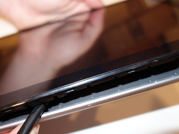

  4. RCA 10 Viking Pro RCT6K03W13 Motherboard Replacement: crwdns2935265:04crwdnd2935265:01crwdnd2935265:02crwdne2935265:0 RCA 10 Viking Pro RCT6K03W13 Motherboard Replacement: crwdns2935265:04crwdnd2935265:02crwdnd2935265:02crwdne2935265:0
    • Work around the outside of the chassis, using the spudger to pry the backplate off.
    • After doing this for about half the device, the backplate should pop right off.

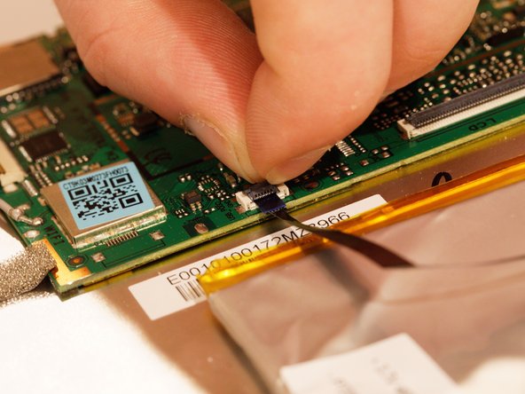

  7. RCA 10 Viking Pro RCT6K03W13 Motherboard Replacement: crwdns2935265:07crwdnd2935265:01crwdnd2935265:01crwdne2935265:0
    • Disconnect the black ribbon cable running over the battery. Flip up the black clamp and pull the cable out.

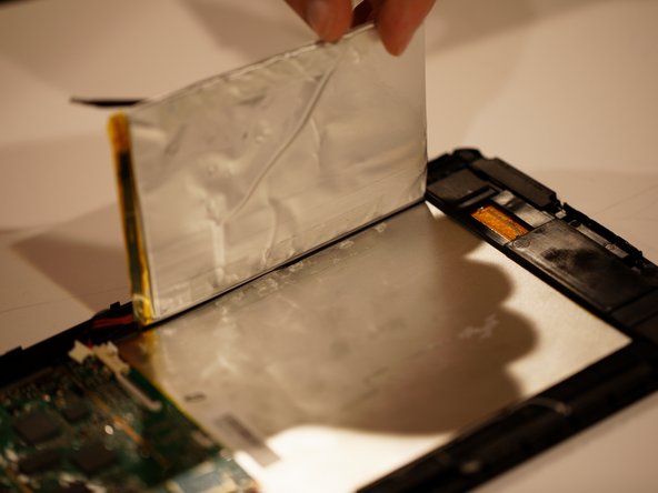

  9. RCA 10 Viking Pro RCT6K03W13 Motherboard Replacement: crwdns2935265:09crwdnd2935265:01crwdnd2935265:02crwdne2935265:0 RCA 10 Viking Pro RCT6K03W13 Motherboard Replacement: crwdns2935265:09crwdnd2935265:02crwdnd2935265:02crwdne2935265:0
    • Pull out battery. It is taped to the device so it is safe to pull out.
    • Look for damage to the battery. If damaged, make sure to not get any acid on your fingers.
