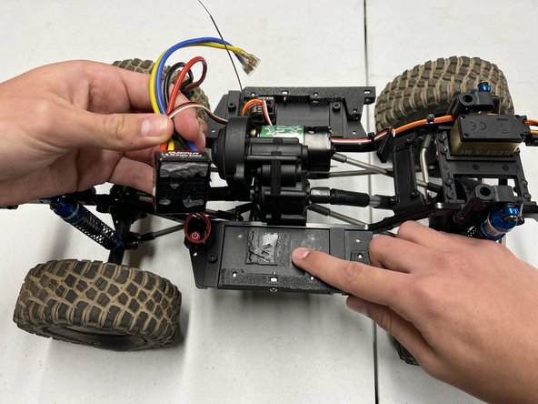

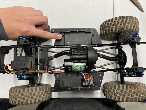

    • Position the car so that the wires are facing upwards.
  2. RC Vehicle Electronic Speed Control Replacement: crwdns2935265:02crwdnd2935265:01crwdnd2935265:03crwdne2935265:0 RC Vehicle Electronic Speed Control Replacement: crwdns2935265:02crwdnd2935265:02crwdnd2935265:03crwdne2935265:0 RC Vehicle Electronic Speed Control Replacement: crwdns2935265:02crwdnd2935265:03crwdnd2935265:03crwdne2935265:0

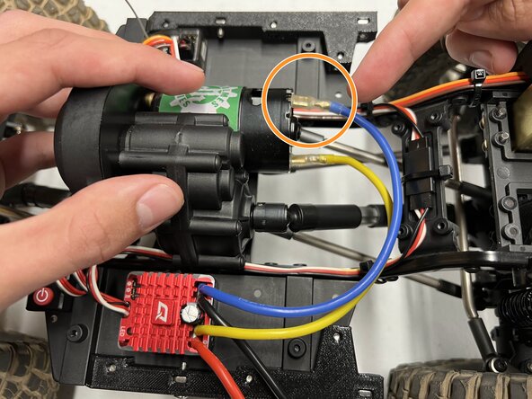

    • Unplug the blue wire.
    • Unplug the yellow wire.
    • To unplug these wires, firmly grasp the metal connector, then pull straight out.
    • Grab the wires by their metal connector, not the wire itself, to prevent any damage to the wires.
  3. RC Vehicle Electronic Speed Control Replacement: crwdns2935265:03crwdnd2935265:01crwdnd2935265:02crwdne2935265:0 RC Vehicle Electronic Speed Control Replacement: crwdns2935265:03crwdnd2935265:02crwdnd2935265:02crwdne2935265:0

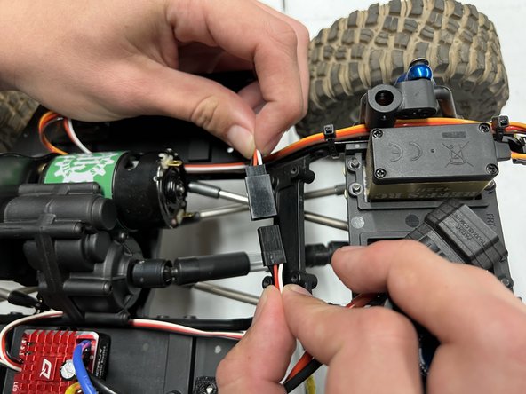

    • Unplug the thin bundle of black, white, and red wires.
    • Move both ends to the side of the car to clear your workspace.

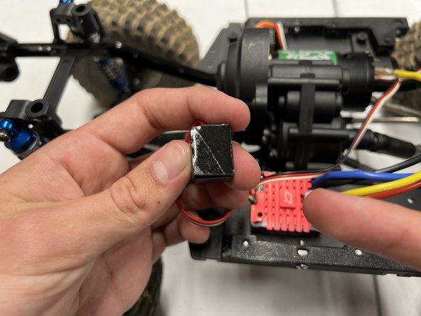

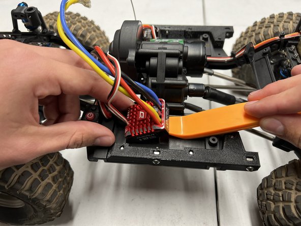

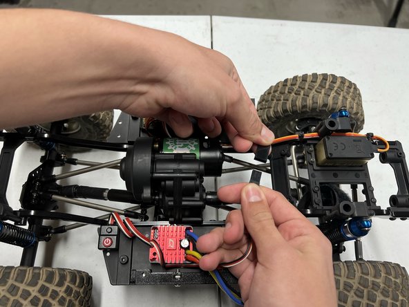

    • Slide an opening tool beneath the red controller unit.
    • Pry upwards with moderate force until the controller unit is detached.
  5. RC Vehicle Electronic Speed Control Replacement: crwdns2935265:05crwdnd2935265:01crwdnd2935265:03crwdne2935265:0 RC Vehicle Electronic Speed Control Replacement: crwdns2935265:05crwdnd2935265:02crwdnd2935265:03crwdne2935265:0 RC Vehicle Electronic Speed Control Replacement: crwdns2935265:05crwdnd2935265:03crwdnd2935265:03crwdne2935265:0
    iFixit Opening Tool
    $1.99

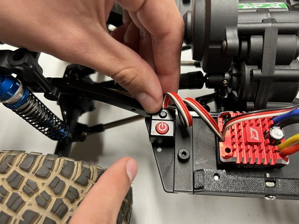

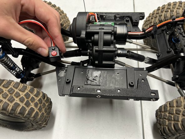

    • Slide an opening tool beneath the power button.
    • Pry upwards with moderate force until the power button is detached.

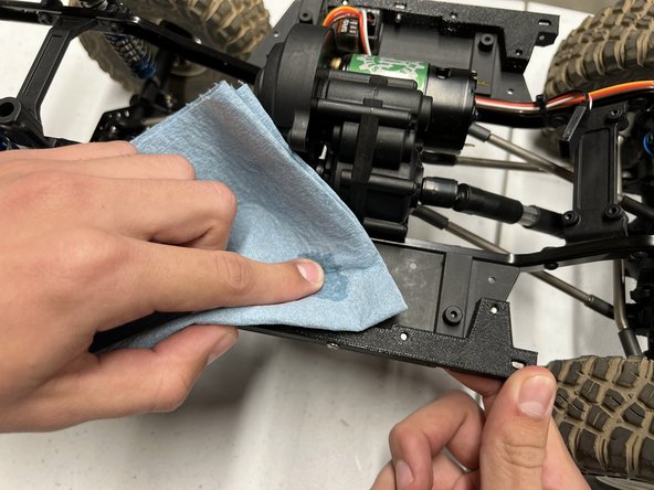

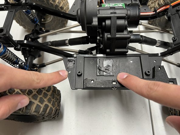

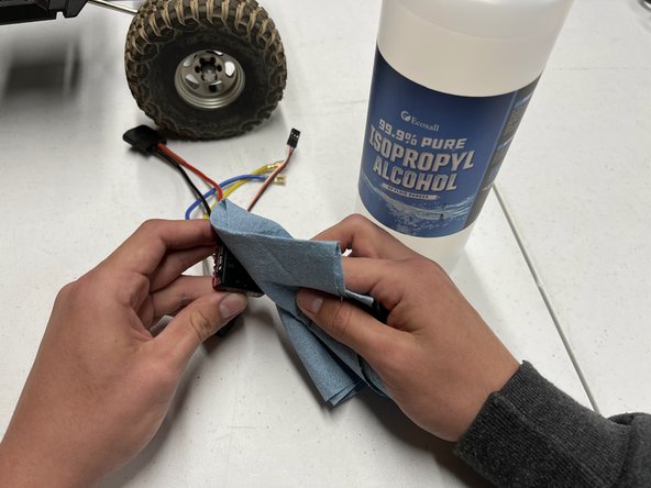

    • Dampen a shop towel with 99.9% pure isopropyl alcohol.
    • Rub the dampened towel over any residual adhesive on the car.
    • Clean the residue until the surface is smooth.
    • Isopropyl alcohol is extremely flammable. Work away from heat sources to prevent serious fires.

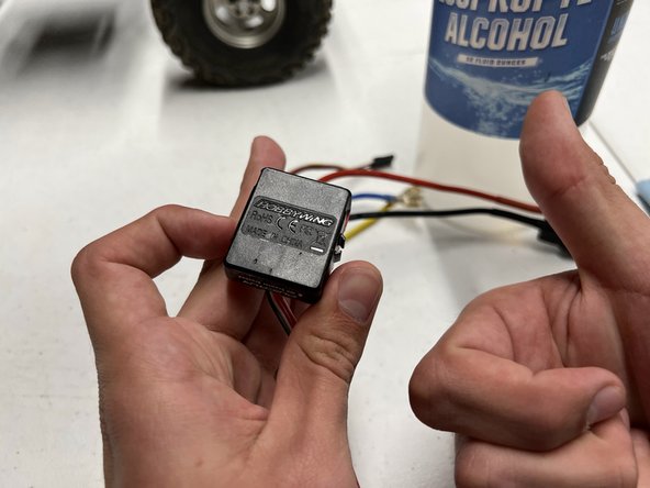

  7. RC Vehicle Electronic Speed Control Replacement: crwdns2935265:07crwdnd2935265:01crwdnd2935265:03crwdne2935265:0 RC Vehicle Electronic Speed Control Replacement: crwdns2935265:07crwdnd2935265:02crwdnd2935265:03crwdne2935265:0 RC Vehicle Electronic Speed Control Replacement: crwdns2935265:07crwdnd2935265:03crwdnd2935265:03crwdne2935265:0
    • From this step onwards, work with your new controller unit, not the old one.
    • Rub the dampened towel over the bottom of the controller unit.

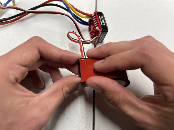

  9. RC Vehicle Electronic Speed Control Replacement: crwdns2935265:09crwdnd2935265:01crwdnd2935265:02crwdne2935265:0 RC Vehicle Electronic Speed Control Replacement: crwdns2935265:09crwdnd2935265:02crwdnd2935265:02crwdne2935265:0

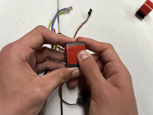

    • Position the controller unit so that the bottom faces upwards.

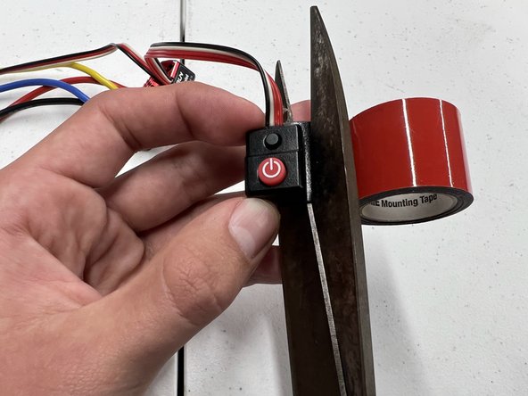

    • Unwind 1 inch of double-sided adhesive.
    • Center the adhesive on the bottom and press down to secure it.
  10. RC Vehicle Electronic Speed Control Replacement: crwdns2935265:010crwdnd2935265:01crwdnd2935265:03crwdne2935265:0 RC Vehicle Electronic Speed Control Replacement: crwdns2935265:010crwdnd2935265:02crwdnd2935265:03crwdne2935265:0 RC Vehicle Electronic Speed Control Replacement: crwdns2935265:010crwdnd2935265:03crwdnd2935265:03crwdne2935265:0
    Utility Scissors
    $5.59

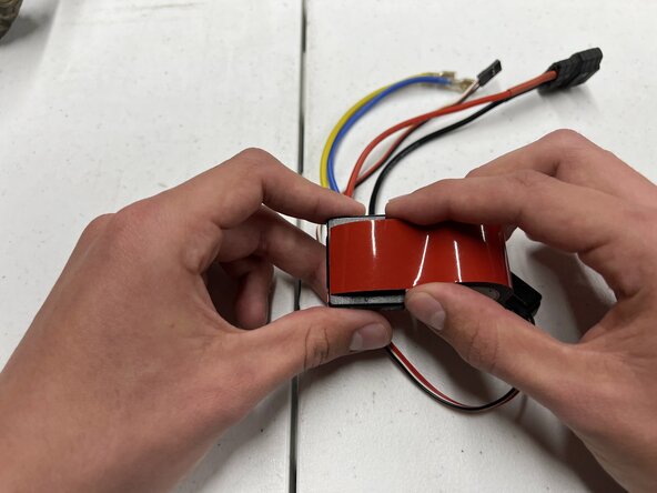

    • Trim any excess adhesive from the bottom of the controller unit.
    • Smooth the adhesive by rubbing it with your thumb.
  11. RC Vehicle Electronic Speed Control Replacement: crwdns2935265:011crwdnd2935265:01crwdnd2935265:03crwdne2935265:0 RC Vehicle Electronic Speed Control Replacement: crwdns2935265:011crwdnd2935265:02crwdnd2935265:03crwdne2935265:0 RC Vehicle Electronic Speed Control Replacement: crwdns2935265:011crwdnd2935265:03crwdnd2935265:03crwdne2935265:0
    • Repeat Steps 9 and 10 with the power button instead of the controller unit.

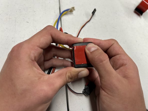

  13. RC Vehicle Electronic Speed Control Replacement: crwdns2935265:013crwdnd2935265:01crwdnd2935265:03crwdne2935265:0 RC Vehicle Electronic Speed Control Replacement: crwdns2935265:013crwdnd2935265:02crwdnd2935265:03crwdne2935265:0 RC Vehicle Electronic Speed Control Replacement: crwdns2935265:013crwdnd2935265:03crwdnd2935265:03crwdne2935265:0

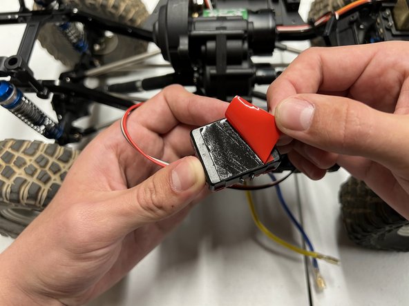

    • Peel off the red layer from the adhesive attached to the controller unit.
    • Secure it to the original spot of the old controller unit.
    • Use a precision knife to easily remove the layer on your double-sided adhesive.
  14. RC Vehicle Electronic Speed Control Replacement: crwdns2935265:014crwdnd2935265:01crwdnd2935265:03crwdne2935265:0 RC Vehicle Electronic Speed Control Replacement: crwdns2935265:014crwdnd2935265:02crwdnd2935265:03crwdne2935265:0 RC Vehicle Electronic Speed Control Replacement: crwdns2935265:014crwdnd2935265:03crwdnd2935265:03crwdne2935265:0
    • Peel off the red layer from the double-sided adhesive attached to the power button.
    • Secure it to the original spot of the old power button.

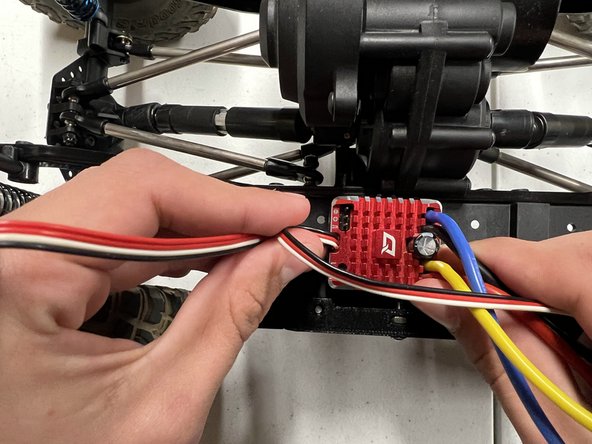

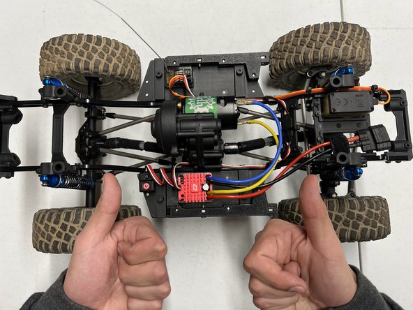

    • Locate the thin bundle of black, white, and red wires and reconnect their heads.

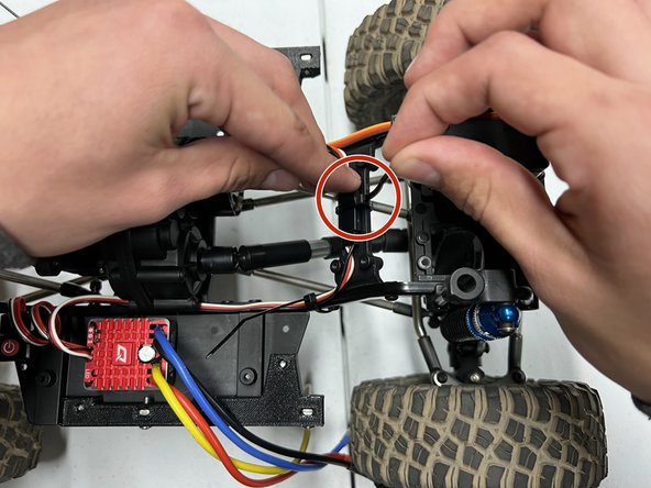

  16. RC Vehicle Electronic Speed Control Replacement: crwdns2935265:016crwdnd2935265:01crwdnd2935265:02crwdne2935265:0 RC Vehicle Electronic Speed Control Replacement: crwdns2935265:016crwdnd2935265:02crwdnd2935265:02crwdne2935265:0
    • Secure the black, white, and red wires to the frame of your car using two 4-inch zip ties.
  17. RC Vehicle Electronic Speed Control Replacement: crwdns2935265:017crwdnd2935265:01crwdnd2935265:03crwdne2935265:0 RC Vehicle Electronic Speed Control Replacement: crwdns2935265:017crwdnd2935265:02crwdnd2935265:03crwdne2935265:0 RC Vehicle Electronic Speed Control Replacement: crwdns2935265:017crwdnd2935265:03crwdnd2935265:03crwdne2935265:0

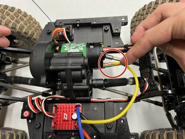

    • Plug the yellow wire into the connector at the bottom of the motor (Image 2).
    • Plug the blue wire into the connector at the top of the motor (Image 3).
  18. RC Vehicle Electronic Speed Control Replacement: crwdns2935265:018crwdnd2935265:01crwdnd2935265:03crwdne2935265:0 RC Vehicle Electronic Speed Control Replacement: crwdns2935265:018crwdnd2935265:02crwdnd2935265:03crwdne2935265:0 RC Vehicle Electronic Speed Control Replacement: crwdns2935265:018crwdnd2935265:03crwdnd2935265:03crwdne2935265:0

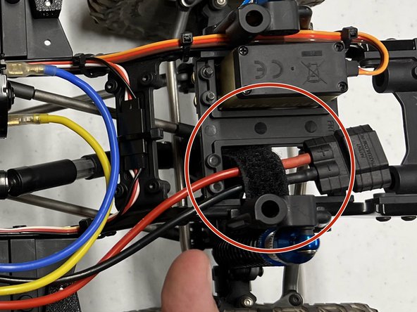

    • Tuck away the thick red and black charging wires.
    • Securing the charging wires using Velcro is optional but recommended to keep the wires from moving while driving your vehicle.
