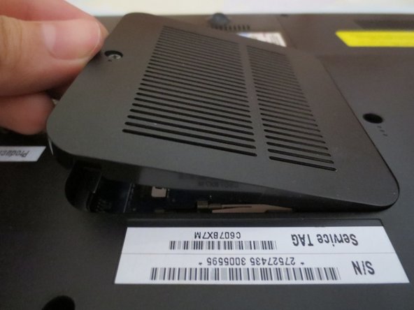

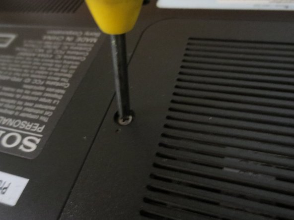

    1. RAM Replacement, RAM: crwdns2935265:03crwdnd2935265:01crwdnd2935265:03crwdne2935265:0 RAM Replacement, RAM: crwdns2935265:03crwdnd2935265:02crwdnd2935265:03crwdne2935265:0 RAM Replacement, RAM: crwdns2935265:03crwdnd2935265:03crwdnd2935265:03crwdne2935265:0
      • Flip the Laptop, and unscrew the RAM cover.

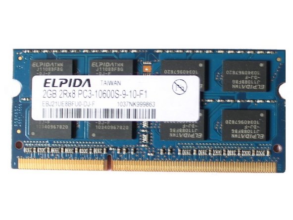

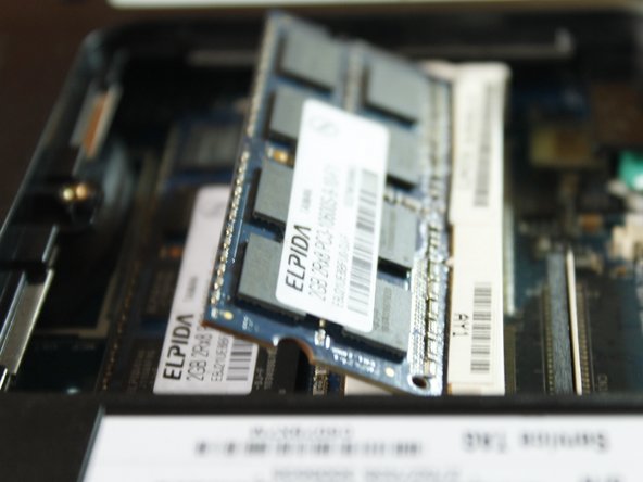

      • Unlock the RAM by pulling the locks outward.
      • You'll know if its unlocked if it flips up in 45 degrees.
    3. RAM Replacement: crwdns2935265:05crwdnd2935265:01crwdnd2935265:02crwdne2935265:0 RAM Replacement: crwdns2935265:05crwdnd2935265:02crwdnd2935265:02crwdne2935265:0
      • Pull the outer RAM. Repeat Step 4 and 5 for the other RAM.
      • When returning, put the RAM back in at 45 degree angle, NOT 90 degree angle.
