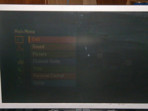

  1. R52WH74 Motherboard Component Replacement, Convergence: crwdns2935265:01crwdnd2935265:01crwdnd2935265:03crwdne2935265:0 R52WH74 Motherboard Component Replacement, Convergence: crwdns2935265:01crwdnd2935265:02crwdnd2935265:03crwdne2935265:0 R52WH74 Motherboard Component Replacement, Convergence: crwdns2935265:01crwdnd2935265:03crwdnd2935265:03crwdne2935265:0
    • Here is what it looks like when the convergence is off.

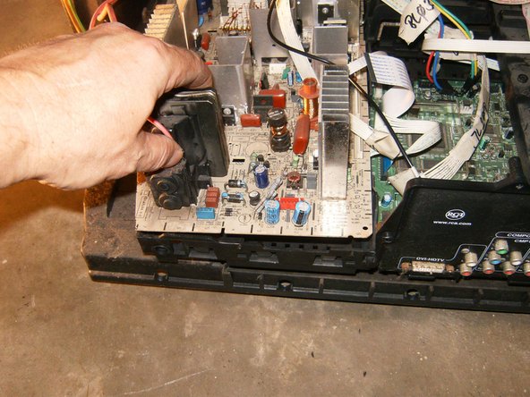

  3. R52WH74 Motherboard Component Replacement: crwdns2935265:03crwdnd2935265:01crwdnd2935265:03crwdne2935265:0 R52WH74 Motherboard Component Replacement: crwdns2935265:03crwdnd2935265:02crwdnd2935265:03crwdne2935265:0 R52WH74 Motherboard Component Replacement: crwdns2935265:03crwdnd2935265:03crwdnd2935265:03crwdne2935265:0

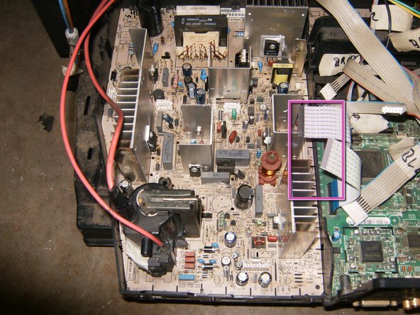

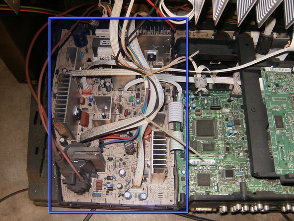

    • This is the deflection power board part number PSB-260
    • Closer look on the the same boards revels all the connectors (definitely not nice)
    • Mark all the cables with a piece of masking tape and there relevant position on the board. This will make assembly easier.

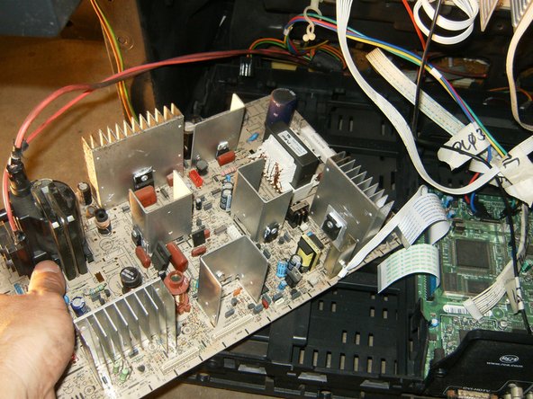

  4. R52WH74 Motherboard Component Replacement: crwdns2935265:04crwdnd2935265:01crwdnd2935265:03crwdne2935265:0 R52WH74 Motherboard Component Replacement: crwdns2935265:04crwdnd2935265:02crwdnd2935265:03crwdne2935265:0 R52WH74 Motherboard Component Replacement: crwdns2935265:04crwdnd2935265:03crwdnd2935265:03crwdne2935265:0
    • Drawing of the connectors on the Power Board
    • Remove all the cables from the power board. Each cable does have its own distinct connector and will not fit into another connector. This will make it easier to re-assemble the chassis.
    • DO NOT REMOVE THE RED WIRES FROM THE FLYBACK TRANSFORMER. Keep those attached.
    • To remove the flat ribbon cables from the BL111 and the BP005 connectors, just pull straight up on the cables. Hold the cable close to the connector end and pull straight up. They are compression connectors and have no clips.

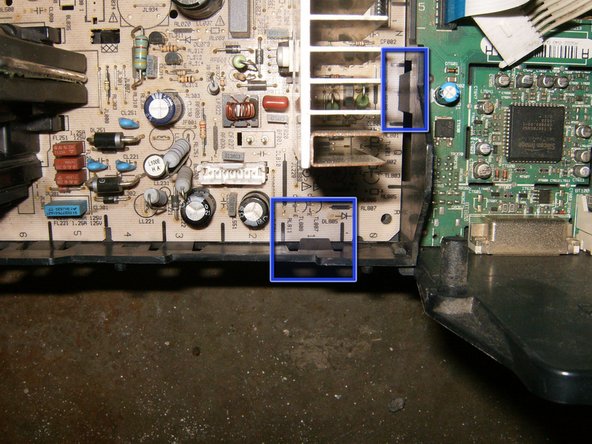

    • The power board is held to the plastic chassis by 8 plastic tabs on the perimeter. Push those away from the board and toward the plastic side.

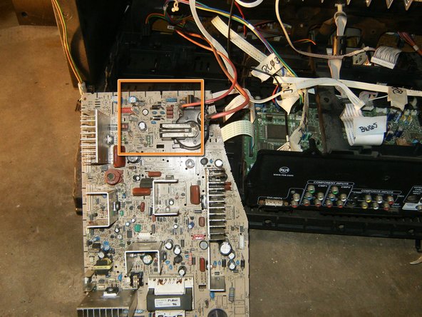

    • There are two plastic tab on the inside of the board. One on the bottom.
    • The other one on the top side.
    • Start at the front side of the plastic chassis and squeeze the tab away from the board, at the same time, lift the board in an angled motion out of the chassis.

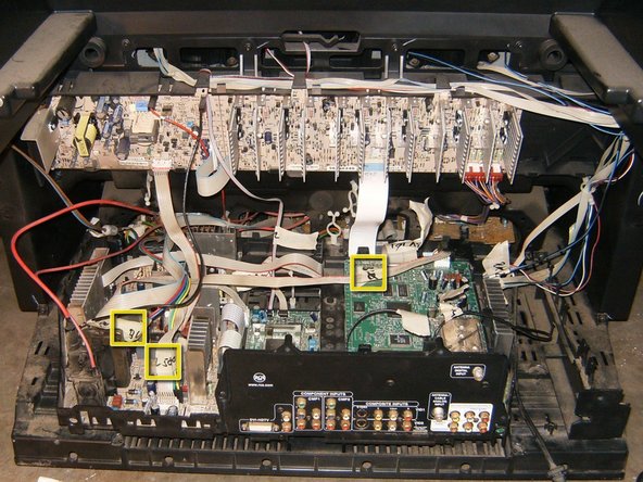

  6. R52WH74 Motherboard Component Replacement: crwdns2935265:06crwdnd2935265:01crwdnd2935265:03crwdne2935265:0 R52WH74 Motherboard Component Replacement: crwdns2935265:06crwdnd2935265:02crwdnd2935265:03crwdne2935265:0 R52WH74 Motherboard Component Replacement: crwdns2935265:06crwdnd2935265:03crwdnd2935265:03crwdne2935265:0
    • Continue to lift until the last of tabs has been cleared.
    • With all the tabs cleared move the board out of the plastic chassis and slightly to the left. There should be enough room with the Fly Back Transformer cables still attached.
    • With the board cleared of the chassis, this is the area that contains all the components that are to be replaced.

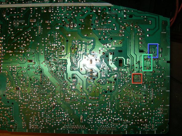

  7. R52WH74 Motherboard Component Replacement: crwdns2935265:07crwdnd2935265:01crwdnd2935265:03crwdne2935265:0 R52WH74 Motherboard Component Replacement: crwdns2935265:07crwdnd2935265:02crwdnd2935265:03crwdne2935265:0 R52WH74 Motherboard Component Replacement: crwdns2935265:07crwdnd2935265:03crwdnd2935265:03crwdne2935265:0

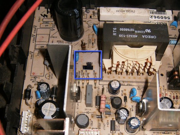

    • Here are the three components:
    • FL231 125V UL FA LL .400A TE5 fuse
    • DL231 Diode Rectifier 1A 600V
    • CL230 Capacitor 100uF 100V

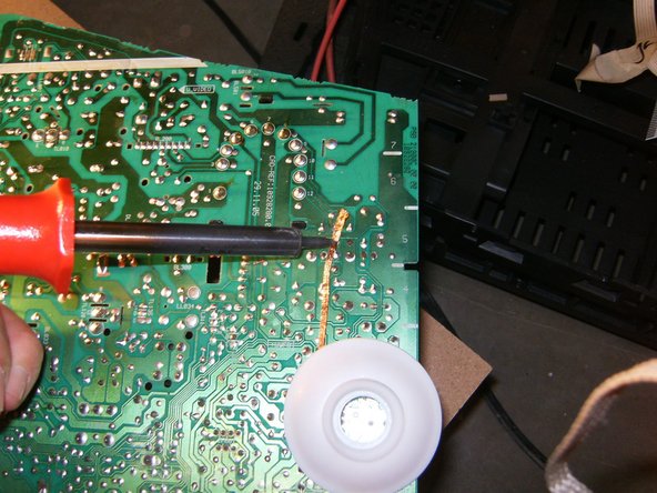

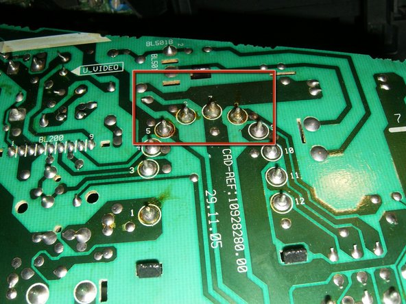

    • Unsolder all three components. Use solder wick and some flux,or a solder sucker.
    • View of the solder side with components removed.
  8. R52WH74 Motherboard Component Replacement: crwdns2935265:08crwdnd2935265:01crwdnd2935265:03crwdne2935265:0 R52WH74 Motherboard Component Replacement: crwdns2935265:08crwdnd2935265:02crwdnd2935265:03crwdne2935265:0 R52WH74 Motherboard Component Replacement: crwdns2935265:08crwdnd2935265:03crwdnd2935265:03crwdne2935265:0

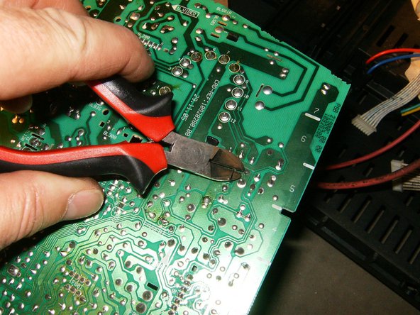

    • Replace the components by guiding the legs through the holes in the board. Bend the legs to the side to keep the component in place. Solder in the usual way.
    • After the component is properly solder to the board, cut the excessive length of the contacts with a pair of side cutters.
