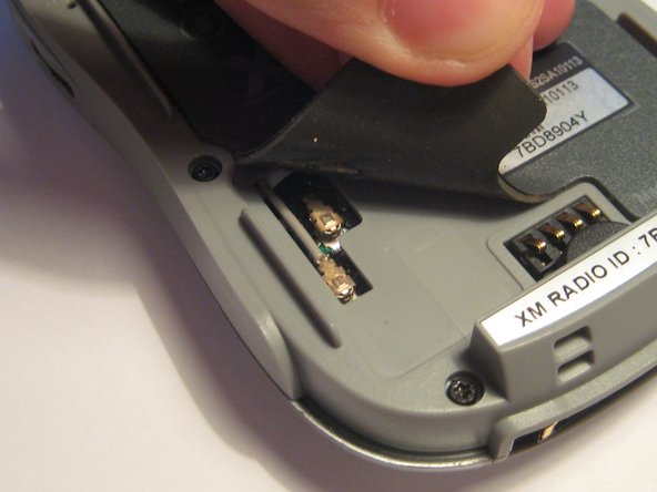

    1. Quick Antenna Connection Check for Delphi MyFi XM2GO, Quick Antenna Connection Check for Delphi MyFi XM2GO: crwdns2935265:03crwdnd2935265:01crwdnd2935265:01crwdne2935265:0
      • Under the battery is a magnetic mat, shown in red, that shields battery interference with the reception of the XM Satellite antenna.
      • This mat is stuck to the back of the device like a sticker and can be removed.
      • CAUTION: Do not operate the device without this magnetic shield.

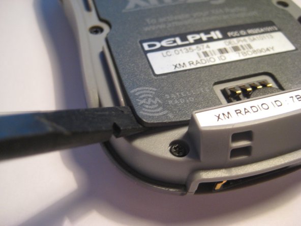

    2. Quick Antenna Connection Check for Delphi MyFi XM2GO: crwdns2935265:04crwdnd2935265:01crwdnd2935265:03crwdne2935265:0 Quick Antenna Connection Check for Delphi MyFi XM2GO: crwdns2935265:04crwdnd2935265:02crwdnd2935265:03crwdne2935265:0 Quick Antenna Connection Check for Delphi MyFi XM2GO: crwdns2935265:04crwdnd2935265:03crwdnd2935265:03crwdne2935265:0
      • On the bottom left side of the magnetic mat, the corner can be lifted up to reveal the U.FL antenna connector. A spudger or your fingernails can be used to pry up the corners.
      • These U.FL antenna connections are standard for most portable devices and WiFi cards. They may become detached through use and may be checked if no reception is present.
      • Lift up the corner and notice the two connectors going to the PCB.

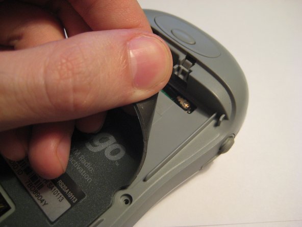

    3. Quick Antenna Connection Check for Delphi MyFi XM2GO: crwdns2935265:05crwdnd2935265:01crwdnd2935265:02crwdne2935265:0 Quick Antenna Connection Check for Delphi MyFi XM2GO: crwdns2935265:05crwdnd2935265:02crwdnd2935265:02crwdne2935265:0
      • Both of these connectors must be firmly attached to the PCB. Try pressing them firmly to make sure they are making full contact.

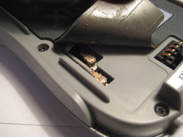

    4. Quick Antenna Connection Check for Delphi MyFi XM2GO: crwdns2935265:06crwdnd2935265:01crwdnd2935265:03crwdne2935265:0 Quick Antenna Connection Check for Delphi MyFi XM2GO: crwdns2935265:06crwdnd2935265:02crwdnd2935265:03crwdne2935265:0 Quick Antenna Connection Check for Delphi MyFi XM2GO: crwdns2935265:06crwdnd2935265:03crwdnd2935265:03crwdne2935265:0
      • On the top right corner, the magnetic mat can be lifted up to check another U.FL connector as with the 3rd step.
      • This mat can be pressed down again to secure after checking the connector.

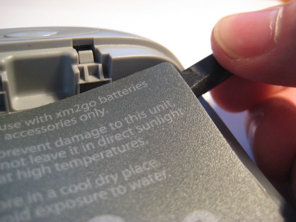

    5. Quick Antenna Connection Check for Delphi MyFi XM2GO: crwdns2935265:07crwdnd2935265:01crwdnd2935265:01crwdne2935265:0
      • Try pressing down on the U.FL connector, as seen in this picture, to ensure a secure connection.
