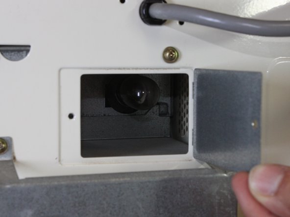

    • Locate the metal panel in the top left corner of the microwave. This covers the lightbulb compartment.
    • Disconnect the Microwave from the power source.
  2. Quasar Microwave Oven MQ7774XW Light Bulb Replacement: crwdns2935265:02crwdnd2935265:01crwdnd2935265:01crwdne2935265:0
    • Unscrew the screw holding the metal panel in place.
  3. Quasar Microwave Oven MQ7774XW Light Bulb Replacement: crwdns2935265:03crwdnd2935265:01crwdnd2935265:02crwdne2935265:0 Quasar Microwave Oven MQ7774XW Light Bulb Replacement: crwdns2935265:03crwdnd2935265:02crwdnd2935265:02crwdne2935265:0
    • Open the metal panel.
  4. Quasar Microwave Oven MQ7774XW Light Bulb Replacement: crwdns2935265:04crwdnd2935265:01crwdnd2935265:02crwdne2935265:0 Quasar Microwave Oven MQ7774XW Light Bulb Replacement: crwdns2935265:04crwdnd2935265:02crwdnd2935265:02crwdne2935265:0

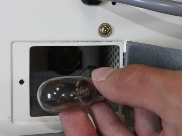

    • Unscrew the light bulb and replace it with a new light bulb.
    • Repeat Steps 2 and 3 in reverse order to complete the replacement.
To reassemble your device, follow Steps 2 and 3 in reverse order.
