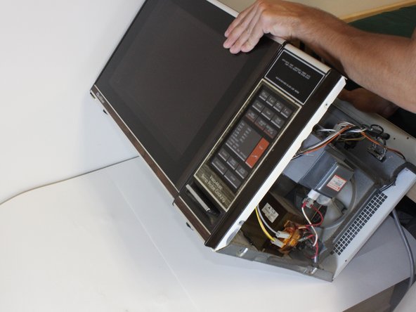

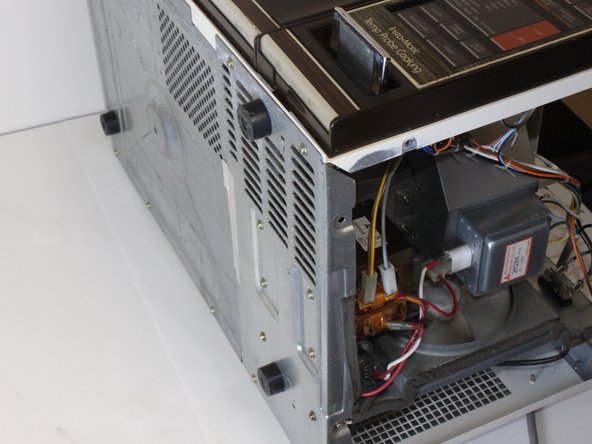

    • Disconnect the power supply cord from the outlet.
  2. Quasar Microwave Capacitor Replacement: crwdns2935265:02crwdnd2935265:01crwdnd2935265:02crwdne2935265:0 Quasar Microwave Capacitor Replacement: crwdns2935265:02crwdnd2935265:02crwdnd2935265:02crwdne2935265:0
    • Remove the eight screws holding the wood-patterned cover to the microwave frame.
    • The first four screws are located on either side of the microwave front.
  3. Quasar Microwave Capacitor Replacement: crwdns2935265:03crwdnd2935265:01crwdnd2935265:02crwdne2935265:0 Quasar Microwave Capacitor Replacement: crwdns2935265:03crwdnd2935265:02crwdnd2935265:02crwdne2935265:0
    • Remove the additional four screws securing the wood-paneled case to the microwave frame.
  4. Quasar Microwave Capacitor Replacement: crwdns2935265:04crwdnd2935265:01crwdnd2935265:03crwdne2935265:0 Quasar Microwave Capacitor Replacement: crwdns2935265:04crwdnd2935265:02crwdnd2935265:03crwdne2935265:0 Quasar Microwave Capacitor Replacement: crwdns2935265:04crwdnd2935265:03crwdnd2935265:03crwdne2935265:0
    • Placing your hands on either side of the case, slide the case back gently until you feel it completely separate from the microwave frame.
    • Lift the case upward slowly until the case is free of the microwave.

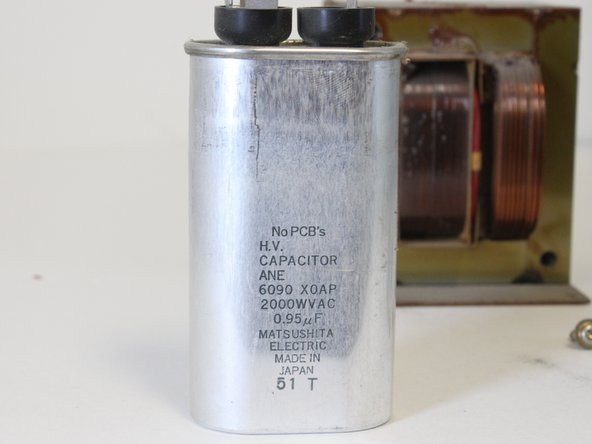

  5. Quasar Microwave Capacitor Replacement, Capacitor: crwdns2935265:05crwdnd2935265:01crwdnd2935265:02crwdne2935265:0 Quasar Microwave Capacitor Replacement, Capacitor: crwdns2935265:05crwdnd2935265:02crwdnd2935265:02crwdne2935265:0
    • Old electronics collect dust, no matter if they are in active use or being stored. It is recommended to clear out some of the dust prior to affecting any complicated repairs. Use compressed air, and wear a dust mask and goggles. Always use precaution when working with old electronics.
    • The capacitor stores a small amount of electrical energy. Discharge capacitor by placing a screw driver across the terminals. Use a screwdriver with a non-metallic handle and a shaft that is longer than 4” (10.75mm) Touch the metal shaft of the screwdriver simultaneously to both metal terminals of the capacitor. There should be a spark.
    • If the capacitor sparks, you can stop reading here. The spark indicates that the capacitor is working properly. If the capacitor does not spark, read on to Step 6.

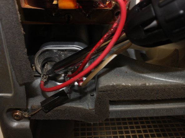

  6. Quasar Microwave Capacitor Replacement: crwdns2935265:06crwdnd2935265:01crwdnd2935265:01crwdne2935265:0
    • Place the multimeter on resistance mode and test the resistance of the capacitor.
    • If the resistance increases/decreases, the capacitor is working fine. If the resistance of the capacitor reads 0 or over several kilo ohms, the capacitor needs to be replaced.

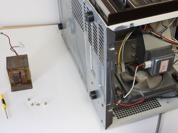

    • Tip the microwave back so it is lying face up. This allows access to the screws beneath the transformer.
  8. Quasar Microwave Capacitor Replacement: crwdns2935265:08crwdnd2935265:01crwdnd2935265:02crwdne2935265:0 Quasar Microwave Capacitor Replacement: crwdns2935265:08crwdnd2935265:02crwdnd2935265:02crwdne2935265:0
    • Locate the transformer. The capacitor cannot be removed without removing the transformer first.
    • Locate and unhook all wires connecting the transformer to the rest of the microwave.
    • Take note of where each wire connects before disconnecting. Wiring a microwave incorrectly can cause serious damage.

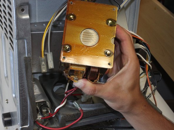

  9. Quasar Microwave Capacitor Replacement: crwdns2935265:09crwdnd2935265:01crwdnd2935265:01crwdne2935265:0
    • Remove the four exterior screws securing the transformer to the microwave frame.
  10. Quasar Microwave Capacitor Replacement: crwdns2935265:010crwdnd2935265:01crwdnd2935265:03crwdne2935265:0 Quasar Microwave Capacitor Replacement: crwdns2935265:010crwdnd2935265:02crwdnd2935265:03crwdne2935265:0 Quasar Microwave Capacitor Replacement: crwdns2935265:010crwdnd2935265:03crwdnd2935265:03crwdne2935265:0
    • Remove the transformer.

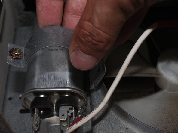

  11. Quasar Microwave Capacitor Replacement: crwdns2935265:011crwdnd2935265:01crwdnd2935265:02crwdne2935265:0 Quasar Microwave Capacitor Replacement: crwdns2935265:011crwdnd2935265:02crwdnd2935265:02crwdne2935265:0
    • The metal band locking the capacitor in place can now be accessed. Locate and remove the screw securing the the metal band.
    • Lift the metal band off the capacitor.
  12. Quasar Microwave Capacitor Replacement: crwdns2935265:012crwdnd2935265:01crwdnd2935265:03crwdne2935265:0 Quasar Microwave Capacitor Replacement: crwdns2935265:012crwdnd2935265:02crwdnd2935265:03crwdne2935265:0 Quasar Microwave Capacitor Replacement: crwdns2935265:012crwdnd2935265:03crwdnd2935265:03crwdne2935265:0
    • Remove the capacitor.
  13. Quasar Microwave Capacitor Replacement: crwdns2935265:013crwdnd2935265:01crwdnd2935265:01crwdne2935265:0
    • You can now install a replacement capacitor.
