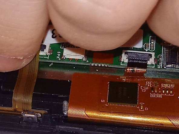

  4. Quantum View 10.1 camera Replacement, Remove camera clip: crwdns2935265:05crwdnd2935265:01crwdnd2935265:02crwdne2935265:0 Quantum View 10.1 camera Replacement, Remove camera clip: crwdns2935265:05crwdnd2935265:02crwdnd2935265:02crwdne2935265:0
    • Remove yellow tape.
    • Unclip ribbon connector.

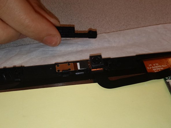

  5. Quantum View 10.1 camera Replacement, Remove camera: crwdns2935265:06crwdnd2935265:01crwdnd2935265:02crwdne2935265:0 Quantum View 10.1 camera Replacement, Remove camera: crwdns2935265:06crwdnd2935265:02crwdnd2935265:02crwdne2935265:0
    • Unscrew plastic camera holder using a PH00 screwdriver bit.
    • Release the plastic holder tab and remove camera.
