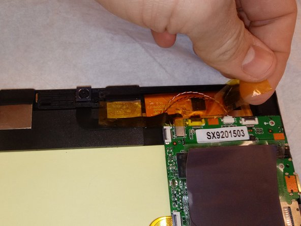

  2. Quantum View 10.1 Motherboard Replacement, Removing the electrical tape and magnets.: crwdns2935265:02crwdnd2935265:01crwdnd2935265:02crwdne2935265:0 Quantum View 10.1 Motherboard Replacement, Removing the electrical tape and magnets.: crwdns2935265:02crwdnd2935265:02crwdnd2935265:02crwdne2935265:0
    • Pick up the magnets from the bottom edge of the tablet next to the keyboard connection and put them in a place that they will not get lost. Then carefully remove all 4 strips of electrical tape.

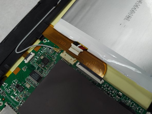

  3. Quantum View 10.1 Motherboard Replacement, Unhooking the battery: crwdns2935265:03crwdnd2935265:01crwdnd2935265:02crwdne2935265:0 Quantum View 10.1 Motherboard Replacement, Unhooking the battery: crwdns2935265:03crwdnd2935265:02crwdnd2935265:02crwdne2935265:0
    • Using a small plastic opening tool; genteelly pull the connection off of the motherboard.

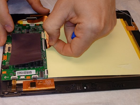

  4. Quantum View 10.1 Motherboard Replacement, Disconnect Cables: crwdns2935265:04crwdnd2935265:01crwdnd2935265:03crwdne2935265:0 Quantum View 10.1 Motherboard Replacement, Disconnect Cables: crwdns2935265:04crwdnd2935265:02crwdnd2935265:03crwdne2935265:0 Quantum View 10.1 Motherboard Replacement, Disconnect Cables: crwdns2935265:04crwdnd2935265:03crwdnd2935265:03crwdne2935265:0
    • Remove silver protective sticker and set to the side.
    • Ensure all ribbon cables and other connectors are disconnected from mother board.

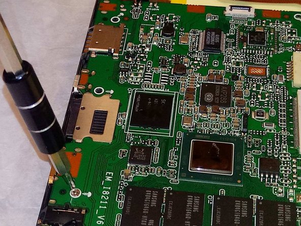

  5. Quantum View 10.1 Motherboard Replacement, Remove Screws: crwdns2935265:05crwdnd2935265:01crwdnd2935265:02crwdne2935265:0 Quantum View 10.1 Motherboard Replacement, Remove Screws: crwdns2935265:05crwdnd2935265:02crwdnd2935265:02crwdne2935265:0
    • There are 4 small screws connecting the motherboard to the frame of the device. Take a PH00 bit screw driver to remove these screws.
