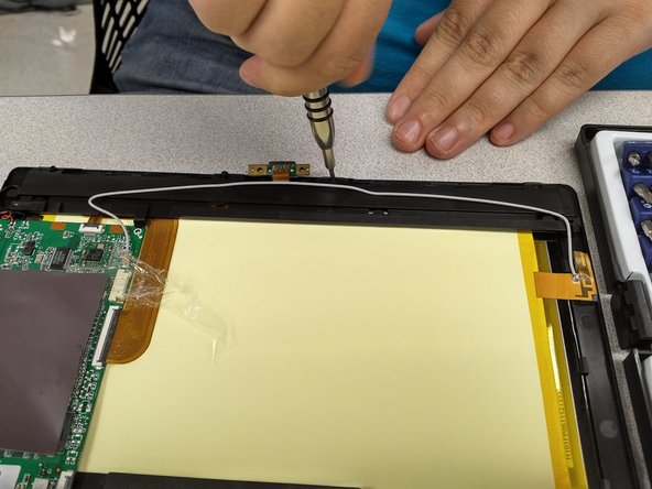

  2. Quantum View 10.1 Keyboard connector solid state board Replacement, Removing the electrical tape and magnets.: crwdns2935265:02crwdnd2935265:01crwdnd2935265:02crwdne2935265:0 Quantum View 10.1 Keyboard connector solid state board Replacement, Removing the electrical tape and magnets.: crwdns2935265:02crwdnd2935265:02crwdnd2935265:02crwdne2935265:0
    • Pick up the magnets from the bottom edge of the tablet next to the keyboard connection and put them in a place that they will not get lost. Then carefully remove all 4 strips of electrical tape.
  3. Quantum View 10.1 Keyboard connector solid state board Replacement, Unhooking the battery: crwdns2935265:03crwdnd2935265:01crwdnd2935265:02crwdne2935265:0 Quantum View 10.1 Keyboard connector solid state board Replacement, Unhooking the battery: crwdns2935265:03crwdnd2935265:02crwdnd2935265:02crwdne2935265:0
    • Using a small plastic opening tool; genteelly pull the connection off of the motherboard.

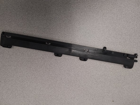

  4. Quantum View 10.1 Keyboard connector solid state board Replacement, Removing cover plate: crwdns2935265:04crwdnd2935265:01crwdnd2935265:03crwdne2935265:0 Quantum View 10.1 Keyboard connector solid state board Replacement, Removing cover plate: crwdns2935265:04crwdnd2935265:02crwdnd2935265:03crwdne2935265:0 Quantum View 10.1 Keyboard connector solid state board Replacement, Removing cover plate: crwdns2935265:04crwdnd2935265:03crwdnd2935265:03crwdne2935265:0
    • Using a PH00 Philips screwdriver bit remove 5 screws from the cover on top of the keyboard solid state board.
    • Then place cover off to the side.

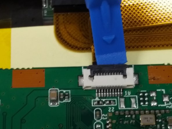

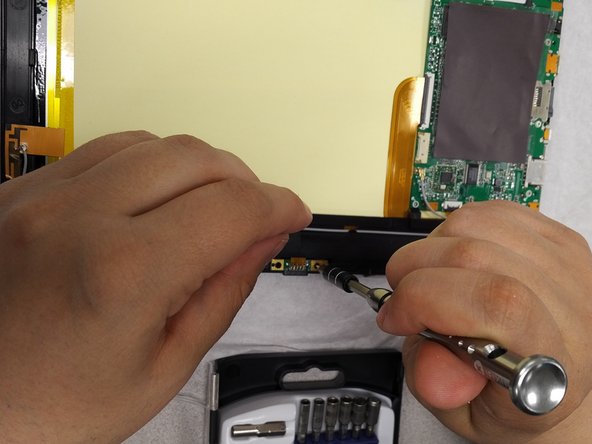

  5. Quantum View 10.1 Keyboard connector solid state board Replacement, Removing the keyboard  solid state board: crwdns2935265:05crwdnd2935265:01crwdnd2935265:03crwdne2935265:0 Quantum View 10.1 Keyboard connector solid state board Replacement, Removing the keyboard  solid state board: crwdns2935265:05crwdnd2935265:02crwdnd2935265:03crwdne2935265:0 Quantum View 10.1 Keyboard connector solid state board Replacement, Removing the keyboard  solid state board: crwdns2935265:05crwdnd2935265:03crwdnd2935265:03crwdne2935265:0
    • Using a PH000 Philips screw driver bit remove the two screws on securing the board to the case.
    • Then using a plastic opening tool slowly and carefully wedge the tool between the cable ribbon and the black connector portion. Then carefully rock the tool up and down to lift the connector hinge.
    • The board can now be removed.
