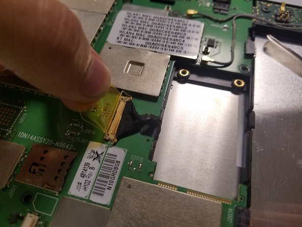

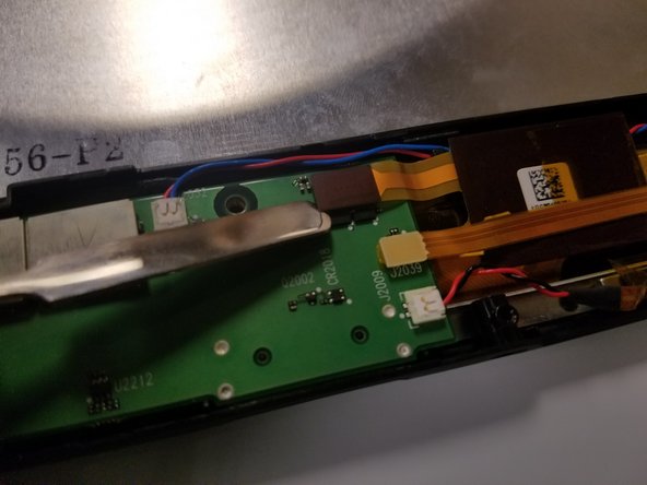

  6. Qualcomm Snapdragon 800 Mobile Development Motherboard Replacement, Motherboard: crwdns2935265:06crwdnd2935265:01crwdnd2935265:03crwdne2935265:0 Qualcomm Snapdragon 800 Mobile Development Motherboard Replacement, Motherboard: crwdns2935265:06crwdnd2935265:02crwdnd2935265:03crwdne2935265:0 Qualcomm Snapdragon 800 Mobile Development Motherboard Replacement, Motherboard: crwdns2935265:06crwdnd2935265:03crwdnd2935265:03crwdne2935265:0
    • Start by disconnecting the cables attached to the motherboard
    • use the spudger to lift the connectors vertically off. They should pop off with relative ease
    • The last connector has a yellow tab. Pull up on the tab until the small metal catch lifts up. Then pull straight back to remove the connector from its socket.
