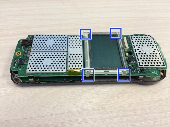

  4. Qualcomm QCP-2760 Keypad Replacement: crwdns2935265:04crwdnd2935265:01crwdnd2935265:02crwdne2935265:0 Qualcomm QCP-2760 Keypad Replacement: crwdns2935265:04crwdnd2935265:02crwdnd2935265:02crwdne2935265:0
    • Place the motherboard down so that the screen is facing up.
    • Grab the small brown connector plug at the sides with a fingernail or tweezers and flip it up.
    • Locate, but do not disconnect, the four screen clips.

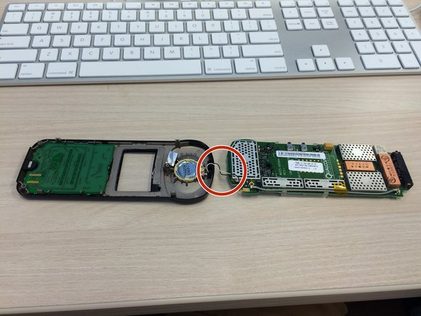

  5. Qualcomm QCP-2760 Keypad Replacement: crwdns2935265:05crwdnd2935265:01crwdnd2935265:02crwdne2935265:0 Qualcomm QCP-2760 Keypad Replacement: crwdns2935265:05crwdnd2935265:02crwdnd2935265:02crwdne2935265:0
    • Flip the motherboard over so that the screen is facing down.
    • Again, be careful not to put stress on the speaker cable.
