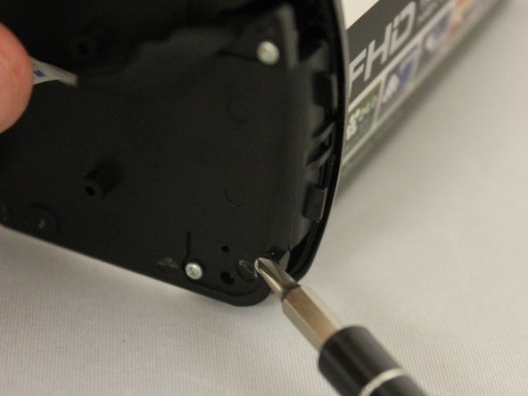

    • Use a #00 screwdriver to remove all six 4 mm screws from the side of the device.

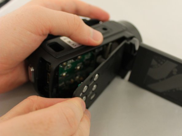

  5. Pyrus PY21S03211 Display Screen Replacement: crwdns2935265:05crwdnd2935265:01crwdnd2935265:02crwdne2935265:0 Pyrus PY21S03211 Display Screen Replacement: crwdns2935265:05crwdnd2935265:02crwdnd2935265:02crwdne2935265:0
    • To remove the side face of the device, you can use a plastic pick to gently pry it off. Be careful while doing so to avoid potential device damage.

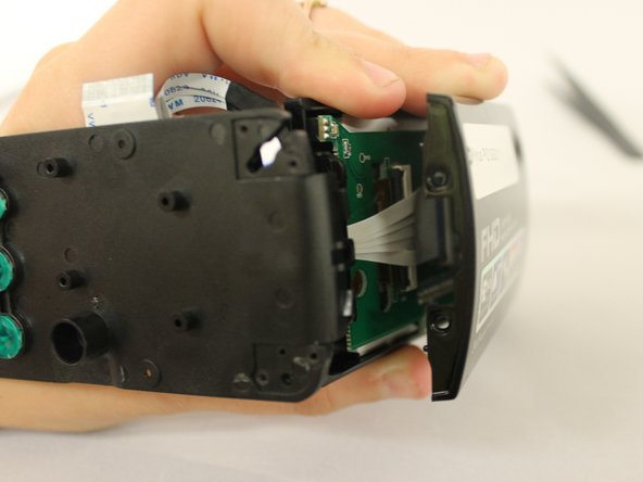

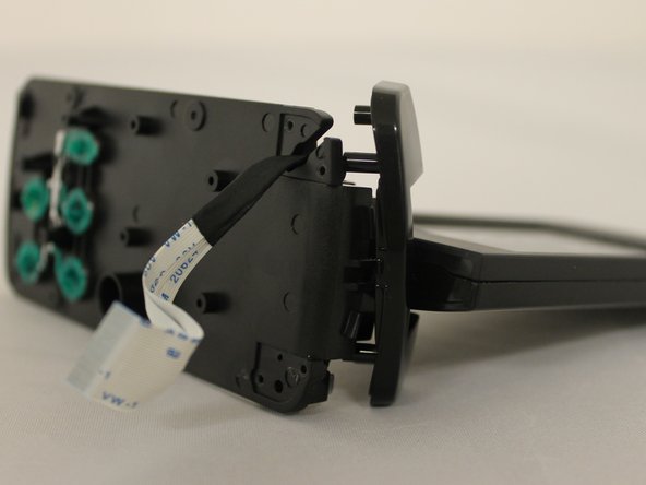

  6. Pyrus PY21S03211 Display Screen Replacement: crwdns2935265:06crwdnd2935265:01crwdnd2935265:01crwdne2935265:0
    • Carefully open the side face. Keep the side face close to the body of the device to avoid pulling on the white wires.
  7. Pyrus PY21S03211 Display Screen Replacement: crwdns2935265:07crwdnd2935265:01crwdnd2935265:02crwdne2935265:0 Pyrus PY21S03211 Display Screen Replacement: crwdns2935265:07crwdnd2935265:02crwdnd2935265:02crwdne2935265:0

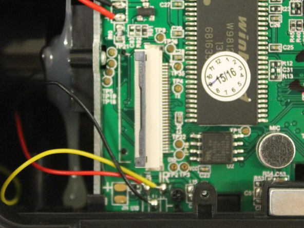

    • To remove the side face completely, locate the big white connector.
    • Lift the grey lip using tweezers. Then, carefully take out the white connector.

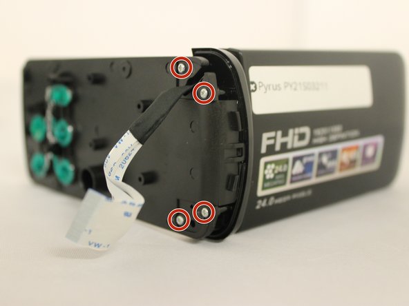

  8. Pyrus PY21S03211 Display Screen Replacement: crwdns2935265:08crwdnd2935265:01crwdnd2935265:03crwdne2935265:0 Pyrus PY21S03211 Display Screen Replacement: crwdns2935265:08crwdnd2935265:02crwdnd2935265:03crwdne2935265:0 Pyrus PY21S03211 Display Screen Replacement: crwdns2935265:08crwdnd2935265:03crwdnd2935265:03crwdne2935265:0

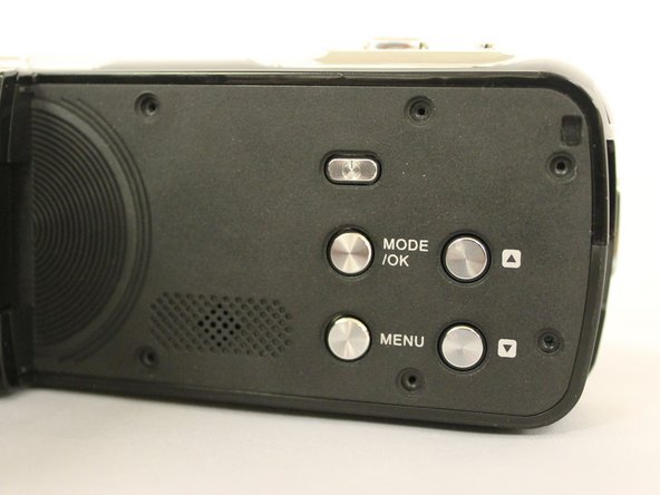

    • Set the device down with the screen facing towards you.
    • Remove the four 4mm silver screws from the back of the side face.

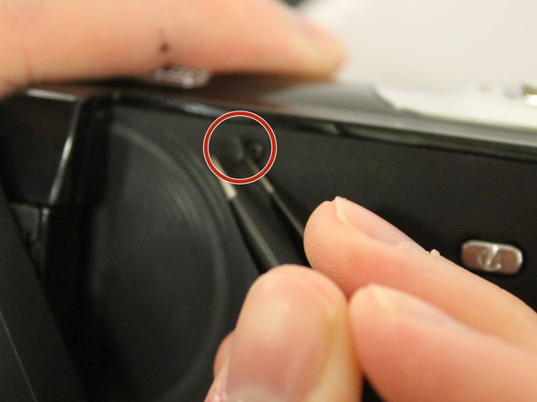

  9. Pyrus PY21S03211 Display Screen Replacement: crwdns2935265:09crwdnd2935265:01crwdnd2935265:02crwdne2935265:0 Pyrus PY21S03211 Display Screen Replacement: crwdns2935265:09crwdnd2935265:02crwdnd2935265:02crwdne2935265:0

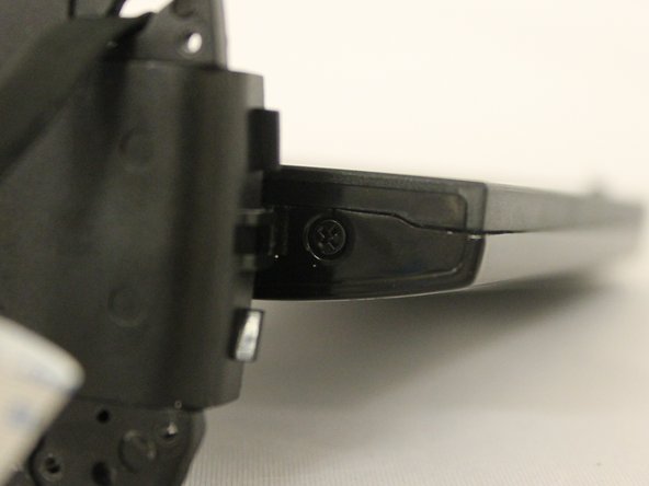

    • Use tweezers to remove the small shiny black plastic corner piece from the side.

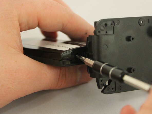

    • Twist the screen to the side to reveal two black 4mm screws.
    • Remove screws from both sides of the screen.

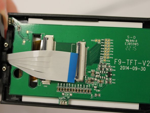

    • Use tweezers to open the gray lip of the large white connector and carefully remove it.

    • To remove the gold transparent connector, gently flip open the grey lip using tweezers.

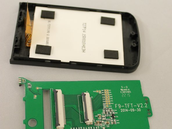

    • Remove green board carefully.

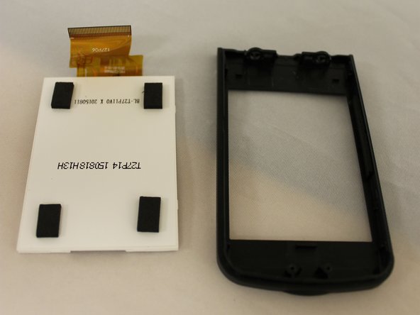

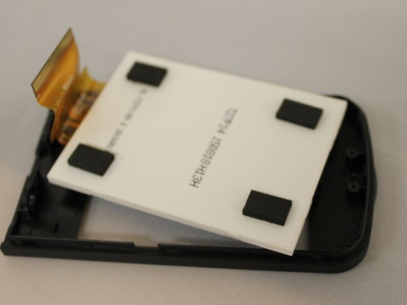

  17. Pyrus PY21S03211 Display Screen Replacement: crwdns2935265:017crwdnd2935265:01crwdnd2935265:03crwdne2935265:0 Pyrus PY21S03211 Display Screen Replacement: crwdns2935265:017crwdnd2935265:02crwdnd2935265:03crwdne2935265:0 Pyrus PY21S03211 Display Screen Replacement: crwdns2935265:017crwdnd2935265:03crwdnd2935265:03crwdne2935265:0
    • Gently remove the white display screen with your hands.
  18. Pyrus PY21S03211 Display Screen Replacement: crwdns2935265:018crwdnd2935265:01crwdnd2935265:01crwdne2935265:0
    • Carefully insert the replacement screen.
