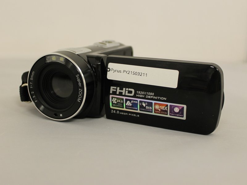

Pyrus PY21S03211 Display Screen Replacement
Display screens can break from falls or scratches. Instead of purchasing a new device, replacing the screen is far more inexpensive. It's very important to keep both the large white connector and the gold connector from being pulled or torn, so keep the side panel close to the motherboard when first opening the device.
If the display on your Pyrus PY21S03211 video camera is broken, follow this guide to replace it.
Before you begin, make sure that the camera is off and unplugged from the charger. Also, make sure to remove the battery.
