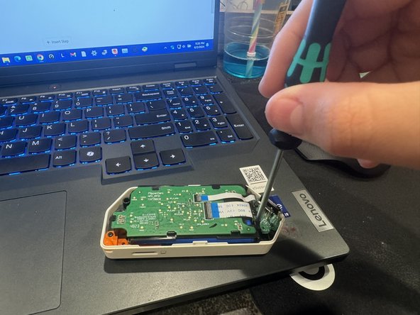

  2. Putting On A Transparent Shell On Flipper Zero, Remove The 4 PH0 Screws On The Back: crwdns2935265:02crwdnd2935265:01crwdnd2935265:03crwdne2935265:0 Putting On A Transparent Shell On Flipper Zero, Remove The 4 PH0 Screws On The Back: crwdns2935265:02crwdnd2935265:02crwdnd2935265:03crwdne2935265:0 Putting On A Transparent Shell On Flipper Zero, Remove The 4 PH0 Screws On The Back: crwdns2935265:02crwdnd2935265:03crwdnd2935265:03crwdne2935265:0
    • Use A PH0 Screwdriver To Open/Remove The Back Part Of The Shell.
    • Be Careful, The Screws Strip Easily. One Way To Combat This Is To Press Down On The Screw While Unscrewing It.

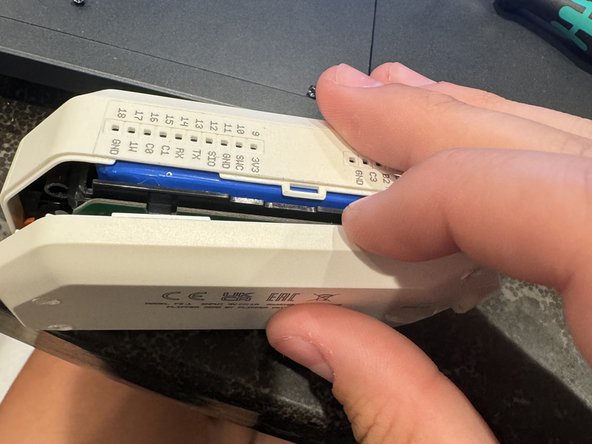

  3. Putting On A Transparent Shell On Flipper Zero, Taking Off The Back Shell: crwdns2935265:03crwdnd2935265:01crwdnd2935265:03crwdne2935265:0 Putting On A Transparent Shell On Flipper Zero, Taking Off The Back Shell: crwdns2935265:03crwdnd2935265:02crwdnd2935265:03crwdne2935265:0 Putting On A Transparent Shell On Flipper Zero, Taking Off The Back Shell: crwdns2935265:03crwdnd2935265:03crwdnd2935265:03crwdne2935265:0
    • Using Your Fingernail, Spudger, Guitar Pick, Or Any Other Prying Tool, Take Off The Back Shell.

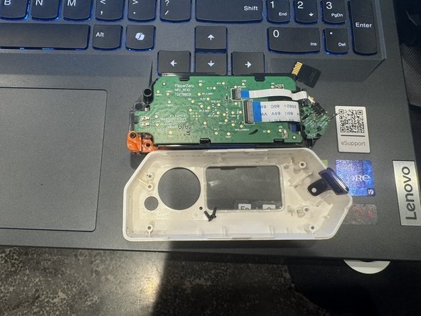

  4. Putting On A Transparent Shell On Flipper Zero, Take Out The Internals: crwdns2935265:04crwdnd2935265:01crwdnd2935265:03crwdne2935265:0 Putting On A Transparent Shell On Flipper Zero, Take Out The Internals: crwdns2935265:04crwdnd2935265:02crwdnd2935265:03crwdne2935265:0 Putting On A Transparent Shell On Flipper Zero, Take Out The Internals: crwdns2935265:04crwdnd2935265:03crwdnd2935265:03crwdne2935265:0
    • Using Your PH0 Screwdriver Unscrew The Two Short Screws Holding The Internals Down To The Shell.
    • Be Careful With The iButton Pins, They Break Off Very Easily.

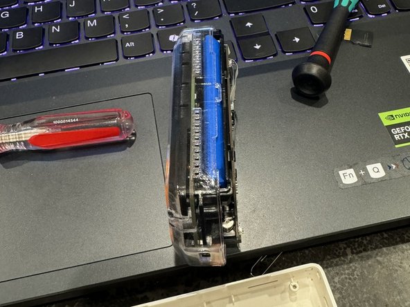

  5. Putting On A Transparent Shell On Flipper Zero, Transfer The Flipper's Internals To The New Shell: crwdns2935265:05crwdnd2935265:01crwdnd2935265:02crwdne2935265:0 Putting On A Transparent Shell On Flipper Zero, Transfer The Flipper's Internals To The New Shell: crwdns2935265:05crwdnd2935265:02crwdnd2935265:02crwdne2935265:0
    • Put Your Flipper's Internals Into The New Shell.
    • Screw The Three Short Screws Back Into Place.
    • Do Not Make The Screws Too Tight As The Threads On The New Transparent Board Will Strip Because It Is 3D Printed.

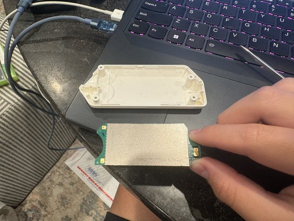

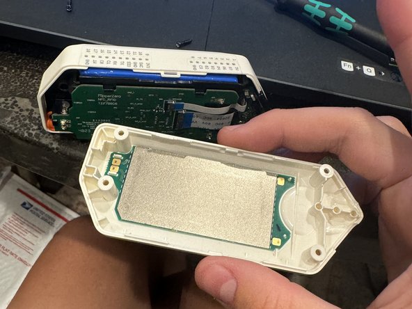

  6. Putting On A Transparent Shell On Flipper Zero, Take The NFC Board Off The Back Shell: crwdns2935265:06crwdnd2935265:01crwdnd2935265:02crwdne2935265:0 Putting On A Transparent Shell On Flipper Zero, Take The NFC Board Off The Back Shell: crwdns2935265:06crwdnd2935265:02crwdnd2935265:02crwdne2935265:0
    • Using Your, Spudger, Guitar Pick, Flathead Screwdriver, Or Any Other Prying Tool, Take Off The NFC Board
    • Do Not Use Your Fingernails To Take Off The NFC Board!
  7. Putting On A Transparent Shell On Flipper Zero, Put The NFC Board Onto The New Transparent Back Shell: crwdns2935265:07crwdnd2935265:01crwdnd2935265:01crwdne2935265:0
    • The NFC Board Should Look Like How It Is In The Picture, If It Doesn't Look Like The Picture Reapply The NFC Board.

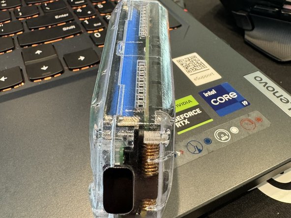

  8. Putting On A Transparent Shell On Flipper Zero, Combine The Two Shells: crwdns2935265:08crwdnd2935265:01crwdnd2935265:02crwdne2935265:0 Putting On A Transparent Shell On Flipper Zero, Combine The Two Shells: crwdns2935265:08crwdnd2935265:02crwdnd2935265:02crwdne2935265:0
    • Put The Two Shells Together And Then Insert The Four Long Screws Into The Screw Holes And Tighten Them.

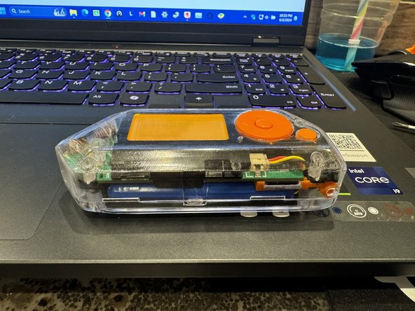

  9. Putting On A Transparent Shell On Flipper Zero, YA DONE!: crwdns2935265:09crwdnd2935265:01crwdnd2935265:02crwdne2935265:0 Putting On A Transparent Shell On Flipper Zero, YA DONE!: crwdns2935265:09crwdnd2935265:02crwdnd2935265:02crwdne2935265:0
    • You Have Just Assembled Yourself A Transparent Flipper Zero, Nice Work!
