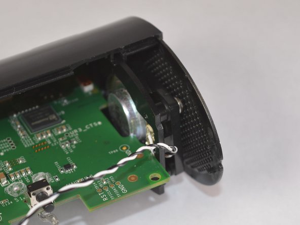

    • Remove the 1.2 cm hex T9 screws and gently open up the device.

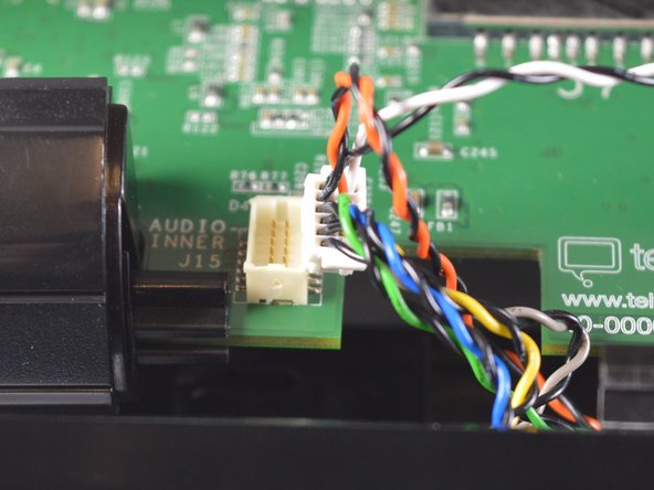

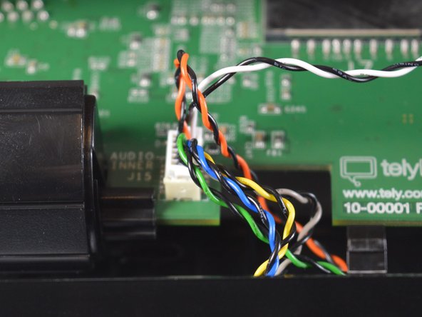

    • Disconnect the speakers from the motherboard.

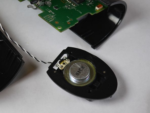

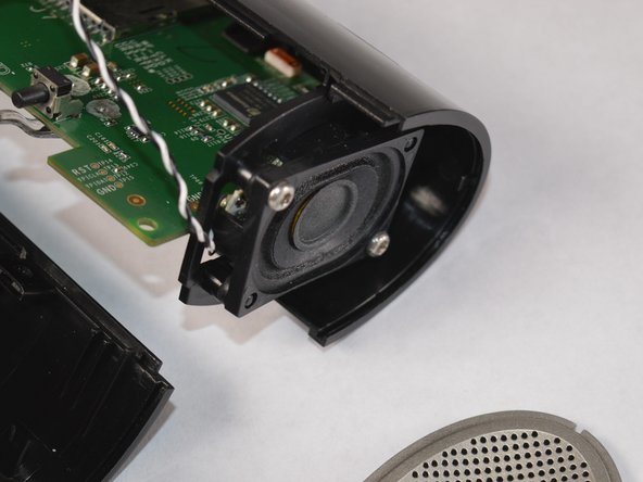

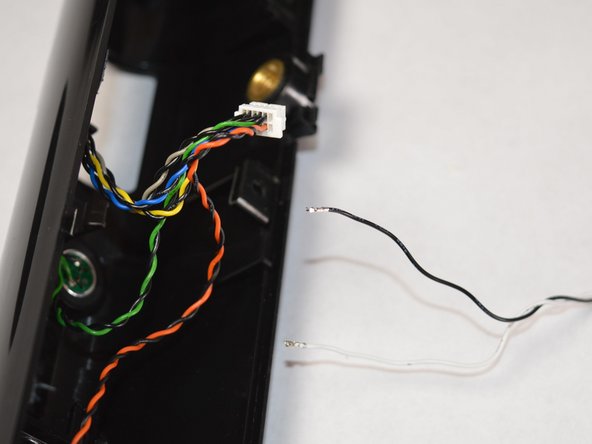

    • Remove the speaker from the plastic shell of the device.
  5. Purple SmartVP Speaker Replacement: crwdns2935265:05crwdnd2935265:01crwdnd2935265:02crwdne2935265:0 Purple SmartVP Speaker Replacement: crwdns2935265:05crwdnd2935265:02crwdnd2935265:02crwdne2935265:0

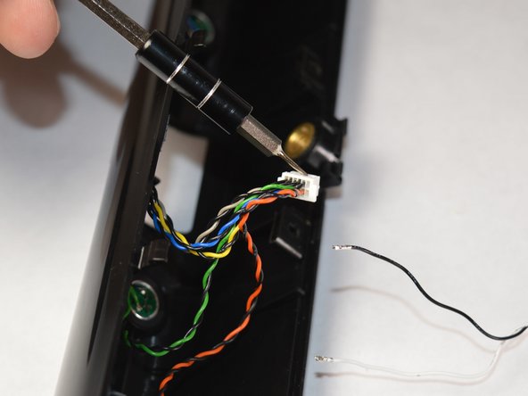

    • Release the wires connected to the speaker from the 12-pin connector with a spudger and replace the affected speaker.
