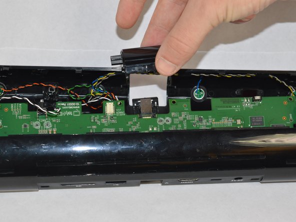

    • Detach the camera cover from the motherboard. Be very careful to not damage any of the components on the motherboard.

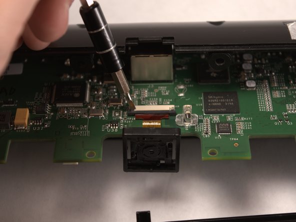

  4. Purple SmartVP Camera Replacement: crwdns2935265:04crwdnd2935265:01crwdnd2935265:02crwdne2935265:0 Purple SmartVP Camera Replacement: crwdns2935265:04crwdnd2935265:02crwdnd2935265:02crwdne2935265:0
    • Use a plastic spudger to push the black sliding cable connector away from the white bracket.
  5. Purple SmartVP Camera Replacement: crwdns2935265:05crwdnd2935265:01crwdnd2935265:01crwdne2935265:0
    • Gently remove the ribbon cable from the connector.
