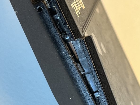

    • Using a knife start prying at the back in the top right corner. Then use a metal spudger to remove the back piece.
    • The back piece is held in place with a (not so strong) sticker and some hooks (see second picture for a side view of the hooks).

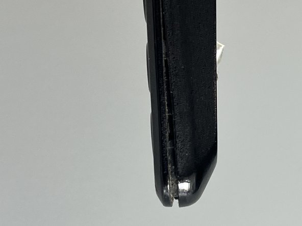

  4. Punkt MP02 Teardown: crwdns2935265:04crwdnd2935265:01crwdnd2935265:03crwdne2935265:0 Punkt MP02 Teardown: crwdns2935265:04crwdnd2935265:02crwdnd2935265:03crwdne2935265:0 Punkt MP02 Teardown: crwdns2935265:04crwdnd2935265:03crwdnd2935265:03crwdne2935265:0
    • using a metal spudger I started separating the two halves of the phone shell on the right of the USB port.
    • by carefully inserting and twisting the spudger I could unclip the two halves to separate them
    • be careful not to insert the spudger too deep, you could damage the mainboard or battery
    • as I wasn't careful enough, the frame broke in two places

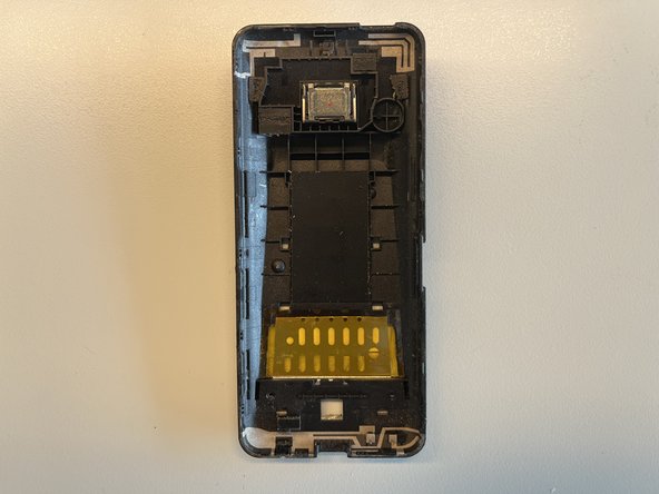

  5. Punkt MP02 Teardown: crwdns2935265:05crwdnd2935265:01crwdnd2935265:02crwdne2935265:0 Punkt MP02 Teardown: crwdns2935265:05crwdnd2935265:02crwdnd2935265:02crwdne2935265:0

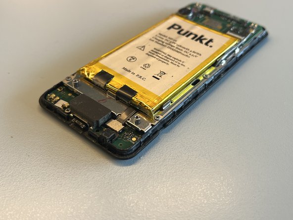

    • now remove the back half
    • I looks like the back contains come antennas and a speaker

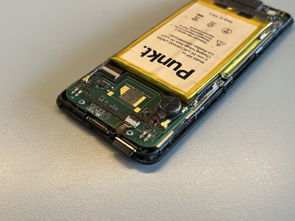

  6. Punkt MP02 Teardown: crwdns2935265:06crwdnd2935265:01crwdnd2935265:03crwdne2935265:0 Punkt MP02 Teardown: crwdns2935265:06crwdnd2935265:02crwdnd2935265:03crwdne2935265:0 Punkt MP02 Teardown: crwdns2935265:06crwdnd2935265:03crwdnd2935265:03crwdne2935265:0
    • now remove the spongy piece that sits ontop of the USB port
    • at this stage I noticed a screw falling on my table and the screw to the right of the USB port was missing
    • I also noticed the screw to the left being loose

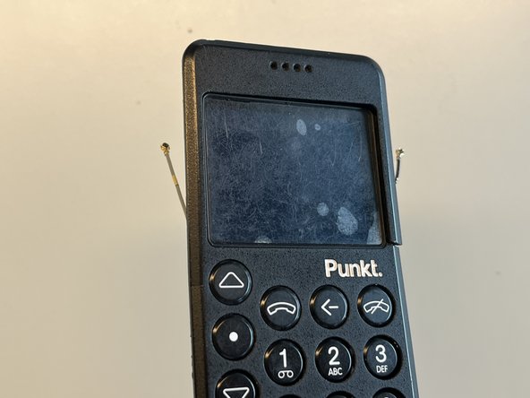

    • I unplugged the two antenna cables
    • unplug the battery connector

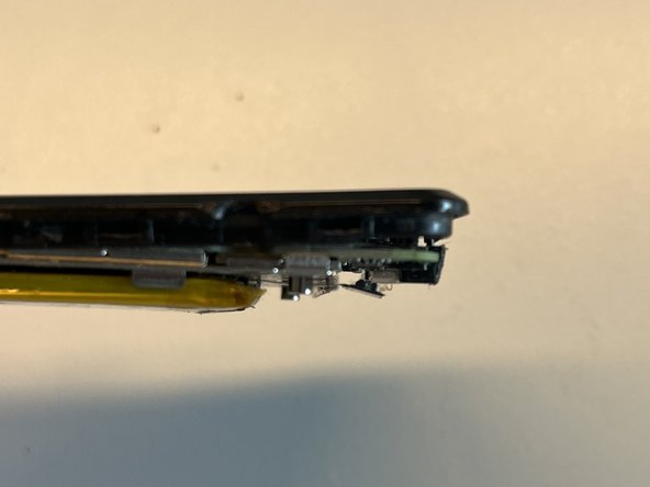

  10. Punkt MP02 Teardown: crwdns2935265:010crwdnd2935265:01crwdnd2935265:03crwdne2935265:0 Punkt MP02 Teardown: crwdns2935265:010crwdnd2935265:02crwdnd2935265:03crwdne2935265:0 Punkt MP02 Teardown: crwdns2935265:010crwdnd2935265:03crwdnd2935265:03crwdne2935265:0
    • at this point the device felt loose and I didn't know how to continue - I noticed after beginning to pull on the battery pull tabs that the mainboard separated
  11. Punkt MP02 Teardown: crwdns2935265:011crwdnd2935265:01crwdnd2935265:01crwdne2935265:0
    • by gently moving the mainboard down (direction of USB port) the mainboard could be separated
    • notice the metal hook that prevents the device from being separated without downwards movement

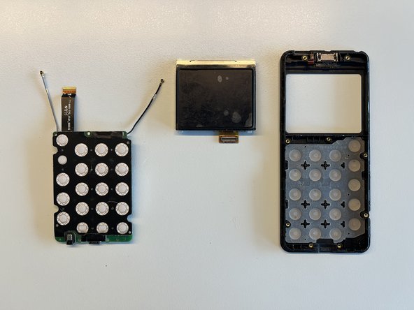

  13. Punkt MP02 Teardown: crwdns2935265:013crwdnd2935265:01crwdnd2935265:02crwdne2935265:0 Punkt MP02 Teardown: crwdns2935265:013crwdnd2935265:02crwdnd2935265:02crwdne2935265:0
    • Now I could remove the screen and main board
