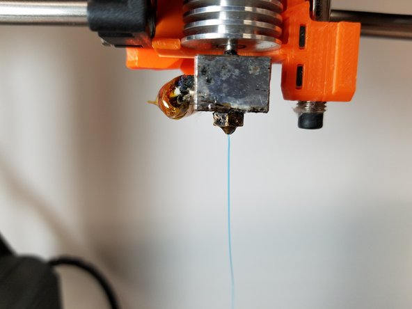

    • Turn the 3D printer on using the power switch.
    • Move the head to the highest position on the Z axis. This provides working room to access the head.
    • Heat the nozzle up. This step depends on what type of filament is currently in the machine (e.g. 190 for PLA, 220 for ABS).
    • Remove filament from the 3D printer.
    • Clean off the old nozzle with tweezers.

    • Make sure the nozzle is heated up before doing this step to prevent damage to the print head.
    • Use an adjustable crescent wrench and a 7mm wrench or socket to remove the old nozzle.
  6. Prusa i3 Mk2  Nozzle Replacement: crwdns2935265:06crwdnd2935265:01crwdnd2935265:03crwdne2935265:0 Prusa i3 Mk2  Nozzle Replacement: crwdns2935265:06crwdnd2935265:02crwdnd2935265:03crwdne2935265:0 Prusa i3 Mk2  Nozzle Replacement: crwdns2935265:06crwdnd2935265:03crwdnd2935265:03crwdne2935265:0
    • Screw in the new nozzle using a socket to get the threads started.
    • Use a crescent wrench and a 7mm wrench or socket to tighten a quarter turn past hand tight.
    • Do not over tighten. Damage to the nozzle or print head could occur.
    • Insert some new filament and push it through to test the connection.
