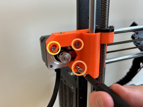

    • Orient the printer so that the screen is facing you.
    • Loosen the 2.5mm X 18mm tension set screw.
    • Loosen the two 2.5mm X 18mm socket head screws on the right, holding on to the X-axis motor.
    • Slightly loosen the 2.5mm X 18mm pivot screw on the left. This screw will act as a pivot for the X-axis motor.
    • Pivot the motor to release the tension on the belt.

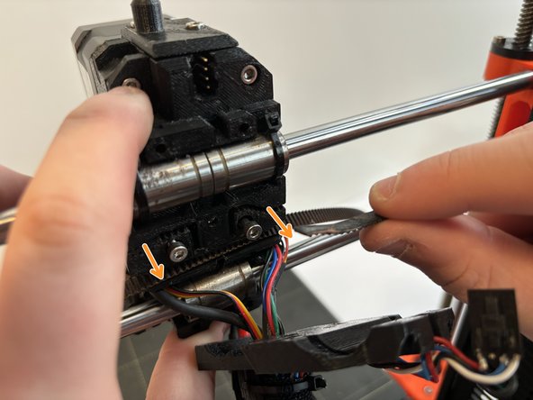

    • Orient the printer so that the screen is facing away from you.
    • Loosen the 2.5mm X 18mm and 2.5mm X 30mm socket head screws that hold the belt in. You do not need to remove these screws.
    • Remove the belt from the belt grips by pulling the belt towards you.
    • Un-feed the belt from its track. The belt should now be removed.

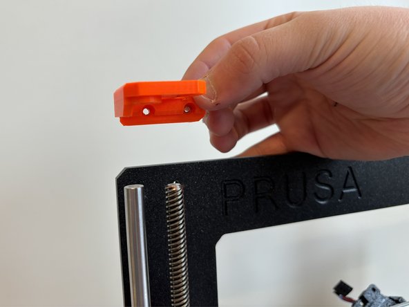

    • Remove the two 2.5mm X 10mm socket head screws that secure the Z-axis rod and screw bracket. Do this for both brackets.
  7. Prusa i3 MK3 Z-Axis Bearings Replacement: crwdns2935265:07crwdnd2935265:01crwdnd2935265:02crwdne2935265:0 Prusa i3 MK3 Z-Axis Bearings Replacement: crwdns2935265:07crwdnd2935265:02crwdnd2935265:02crwdne2935265:0

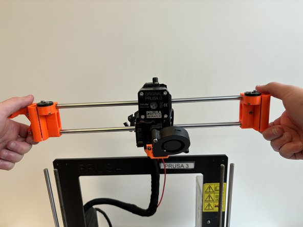

    • Lift the X-axis carriage off of the Z-axis rod and screw.
    • The X-axis motor can be removed and placed to the side for easier disassembly.
    • Be careful not to damage any of the wiring.

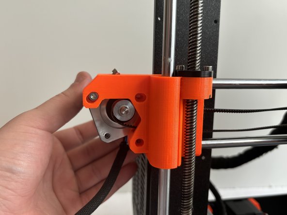

    • Place the X-axis carriage on the build plate so that the front of the extruder assembly is facing you.
    • Remove the two 2.5mm X 18mm socket head screws on both of the Z-axis screw guides. There is one on each side of the carriage assembly.
  9. Prusa i3 MK3 Z-Axis Bearings Replacement: crwdns2935265:09crwdnd2935265:01crwdnd2935265:02crwdne2935265:0 Prusa i3 MK3 Z-Axis Bearings Replacement: crwdns2935265:09crwdnd2935265:02crwdnd2935265:02crwdne2935265:0

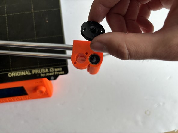

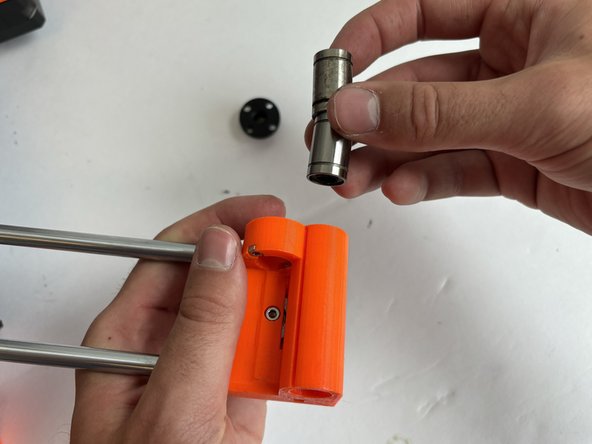

    • Orient the X-axis carriage so that the bottom of the screw guide is facing you.
    • Use a blunt ram tool to push the Z-axis bearings out of the housing. Be sure to push the bearings out from the bottom side.
  10. Prusa i3 MK3 Z-Axis Bearings Replacement: crwdns2935265:010crwdnd2935265:01crwdnd2935265:02crwdne2935265:0 Prusa i3 MK3 Z-Axis Bearings Replacement: crwdns2935265:010crwdnd2935265:02crwdnd2935265:02crwdne2935265:0

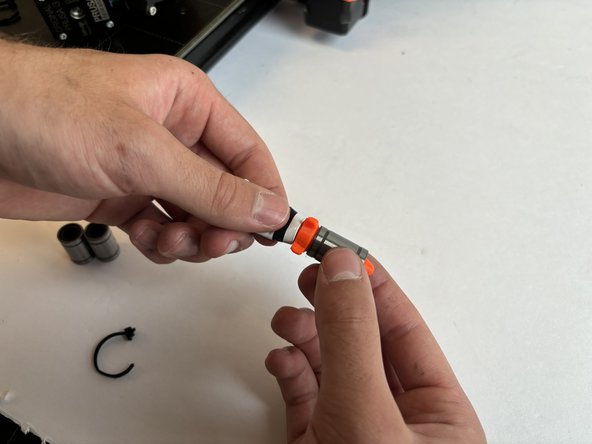

    • During reassembly, grease the Z-axis bearings with the PRUSA Lubricant Applicator.
To reassemble your device, follow these instructions in reverse order. Use Step 9 for reference.
