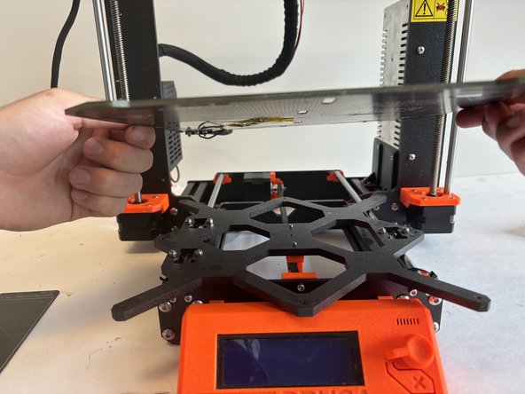

  3. Prusa i3 MK3 Y-Axis Bearings Replacement: crwdns2935265:03crwdnd2935265:01crwdnd2935265:02crwdne2935265:0 Prusa i3 MK3 Y-Axis Bearings Replacement: crwdns2935265:03crwdnd2935265:02crwdnd2935265:02crwdne2935265:0
    • Remove the nine 2.5mm X 12mm flat-head countersink screws from the heat bead.
    • Lift and set the heat bed aside to access the heat bed mounting bracket.

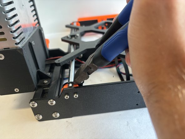

    • Use the side cutters to cut and remove the four zip ties that secure the Y-axis rods.

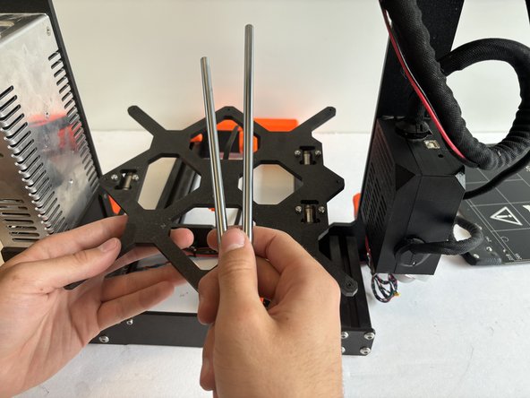

    • Lift the heat bed mounting bracket assembly from the printer.
    • Remove the Y-axis rods from the heat bed mounting bracket assembly.

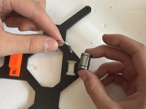

  8. Prusa i3 MK3 Y-Axis Bearings Replacement: crwdns2935265:08crwdnd2935265:01crwdnd2935265:02crwdne2935265:0 Prusa i3 MK3 Y-Axis Bearings Replacement: crwdns2935265:08crwdnd2935265:02crwdnd2935265:02crwdne2935265:0
    • Orient the heat bed mounting bracket so that you are looking at the top side.
    • Use the 5.5mm nut driver to remove the six 5.5mm u-bolt nuts.
    • Orient the heat bed mounting bracket so that you are looking at the bottom side.
    • Remove the three sets of U-bolts and Y-axis bearings.

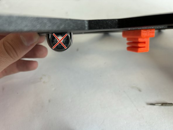

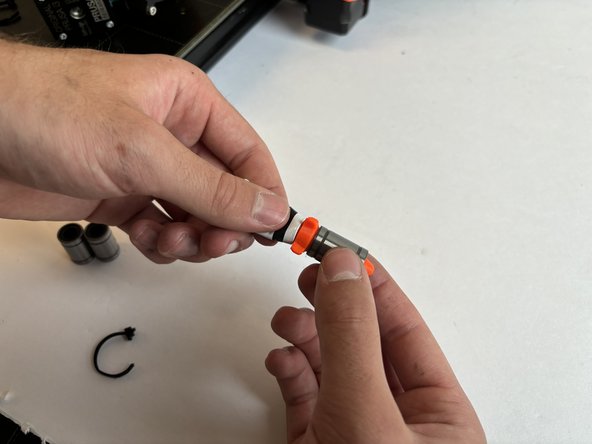

  9. Prusa i3 MK3 Y-Axis Bearings Replacement: crwdns2935265:09crwdnd2935265:01crwdnd2935265:03crwdne2935265:0 Prusa i3 MK3 Y-Axis Bearings Replacement: crwdns2935265:09crwdnd2935265:02crwdnd2935265:03crwdne2935265:0 Prusa i3 MK3 Y-Axis Bearings Replacement: crwdns2935265:09crwdnd2935265:03crwdnd2935265:03crwdne2935265:0
    • During reassembly, grease the Y-axis bearings with the PRUSA Lubricant Applicator.
    • When reinstalling the Y-axis bearings, the balls inside the bearings should form a diagonal "X", not a vertical "+".
To reassemble your device, follow these instructions in reverse order. Use Step 9 for reference.
