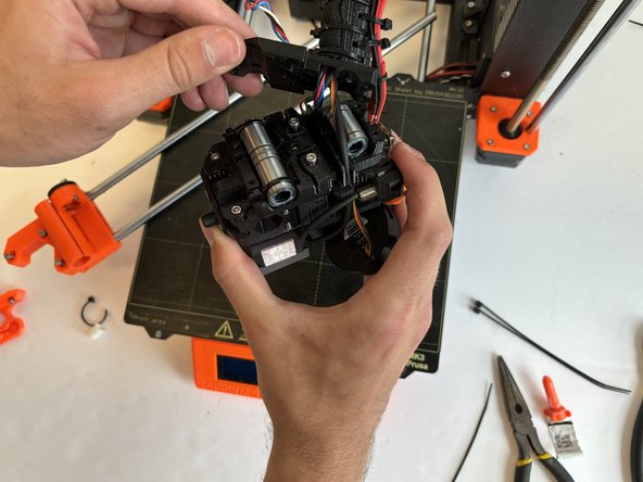

  8. Prusa i3 MK3 X-Axis Bearings Replacement, X-Axis Bearings: crwdns2935265:08crwdnd2935265:01crwdnd2935265:03crwdne2935265:0 Prusa i3 MK3 X-Axis Bearings Replacement, X-Axis Bearings: crwdns2935265:08crwdnd2935265:02crwdnd2935265:03crwdne2935265:0 Prusa i3 MK3 X-Axis Bearings Replacement, X-Axis Bearings: crwdns2935265:08crwdnd2935265:03crwdnd2935265:03crwdne2935265:0

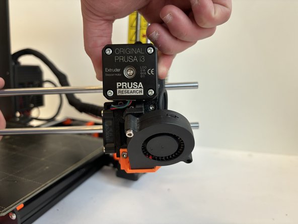

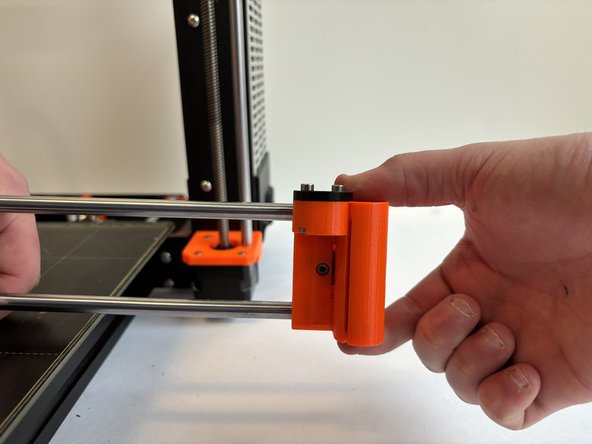

    • Place the X-axis carriage on the build plate and orient it so that the front of the extruder assembly is facing you.
    • Hold the X-axis rods and pull the rod mounting bracket off of the right side of the carriage assembly.
    • Carefully slide the extruder assembly to the right off of the X-axis rods.
  9. Prusa i3 MK3 X-Axis Bearings Replacement: crwdns2935265:09crwdnd2935265:01crwdnd2935265:02crwdne2935265:0 Prusa i3 MK3 X-Axis Bearings Replacement: crwdns2935265:09crwdnd2935265:02crwdnd2935265:02crwdne2935265:0

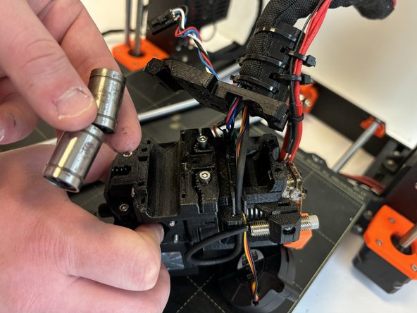

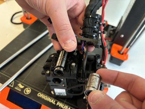

    • Place the front of the extruder assembly on the build plate so you can access the back.
    • Locate the X-axis bearings on the back of the extruder assembly.
    • Remove the lower bearing; it is not secured by zip ties.

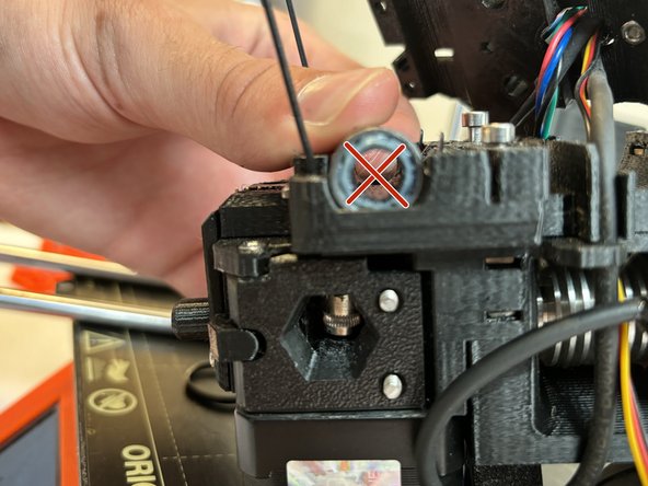

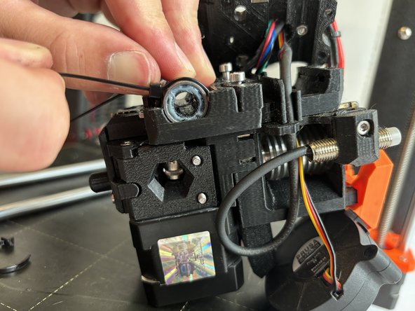

  10. Prusa i3 MK3 X-Axis Bearings Replacement: crwdns2935265:010crwdnd2935265:01crwdnd2935265:03crwdne2935265:0 Prusa i3 MK3 X-Axis Bearings Replacement: crwdns2935265:010crwdnd2935265:02crwdnd2935265:03crwdne2935265:0 Prusa i3 MK3 X-Axis Bearings Replacement: crwdns2935265:010crwdnd2935265:03crwdnd2935265:03crwdne2935265:0

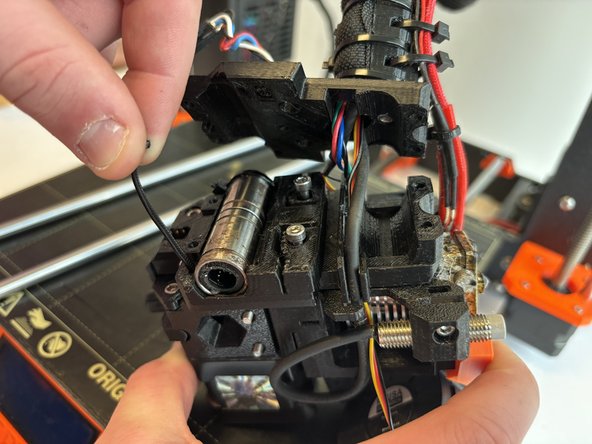

    • Use the side cutters to cut the existing zip ties.
    • Pull the zip ties out of the housing and discard.
    • Remove the top two bearings from the extruder assembly.
  11. Prusa i3 MK3 X-Axis Bearings Replacement: crwdns2935265:011crwdnd2935265:01crwdnd2935265:03crwdne2935265:0 Prusa i3 MK3 X-Axis Bearings Replacement: crwdns2935265:011crwdnd2935265:02crwdnd2935265:03crwdne2935265:0 Prusa i3 MK3 X-Axis Bearings Replacement: crwdns2935265:011crwdnd2935265:03crwdnd2935265:03crwdne2935265:0

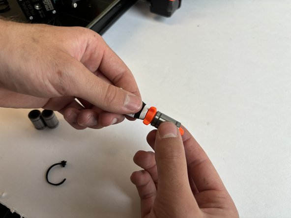

    • During reassembly, grease the X-axis bearings with the PRUSA Lubricant Applicator.
    • When reinstalling the X-axis bearings, the balls inside the bearings should form a diagonal "X", not a vertical "+".
  12. Prusa i3 MK3 X-Axis Bearings Replacement: crwdns2935265:012crwdnd2935265:01crwdnd2935265:03crwdne2935265:0 Prusa i3 MK3 X-Axis Bearings Replacement: crwdns2935265:012crwdnd2935265:02crwdnd2935265:03crwdne2935265:0 Prusa i3 MK3 X-Axis Bearings Replacement: crwdns2935265:012crwdnd2935265:03crwdnd2935265:03crwdne2935265:0
    • During reassembly, slide the zip ties back into the slots of the housing and tighten them to secure the top two bearings.
