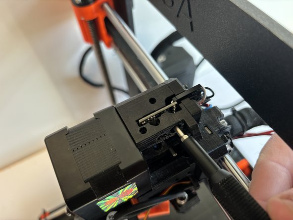

  2. Prusa i3 MK3 Filament Sensor Replacement: crwdns2935265:02crwdnd2935265:01crwdnd2935265:03crwdne2935265:0 Prusa i3 MK3 Filament Sensor Replacement: crwdns2935265:02crwdnd2935265:02crwdnd2935265:03crwdne2935265:0 Prusa i3 MK3 Filament Sensor Replacement: crwdns2935265:02crwdnd2935265:03crwdnd2935265:03crwdne2935265:0

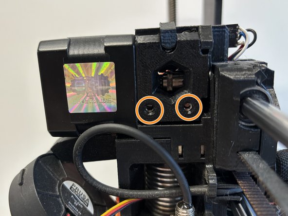

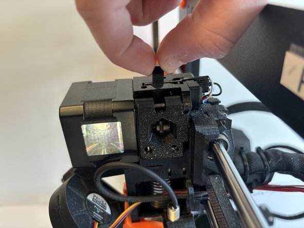

    • Orient the printer so that the top of the extruder head can be accessed.
    • Remove the two 2.5mm X 10mm socket head screws. These screws secure the cover of the filament sensor.
    • Remove the filament sensor cover.

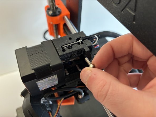

  3. Prusa i3 MK3 Filament Sensor Replacement: crwdns2935265:03crwdnd2935265:01crwdnd2935265:02crwdne2935265:0 Prusa i3 MK3 Filament Sensor Replacement: crwdns2935265:03crwdnd2935265:02crwdnd2935265:02crwdne2935265:0
    • Orient the printer so that the screen is facing to the right.
    • Loosen the two 2.5mm X 40mm socket head screws while holding the extruder head firmly, keeping pressure on the opposite side.
    • Ensure the screws have cleared the embedded square nuts on the back side.
    • Be careful not to lose the small springs that are held in place by the screws.

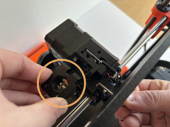

    • Orient the printer so that the screen is facing to the left.
    • Remove the 3D-printed cover piece on top of the extruder access door. (Your printer might be missing this part.)

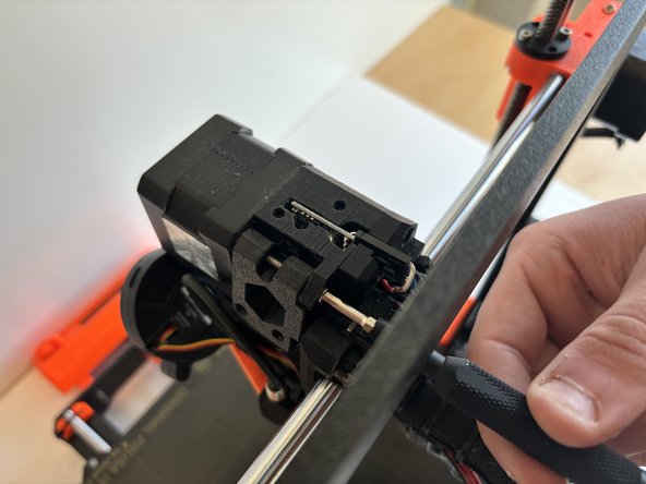

    • Orient the printer so that the screen is facing away from you.
    • Remove the 2.5mm X 30mm socket head screw located on the top left of the backside of the extruder head.
    • Rotate the printer so that the screen is facing to the left.
    • Remove the extruder access door from the extruder head.
    • Be careful not to lose the square nuts that hold the screws removed in Step 3. (They sit inside the extruder access door.)

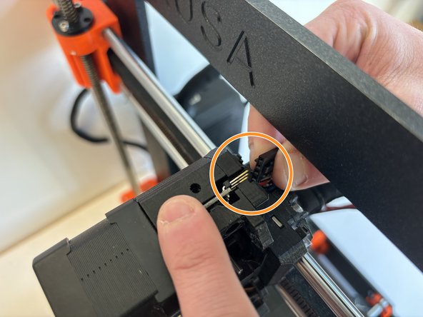

    • Remove the 2.5mm X 10mm socket head screw located behind the extruder access door that was removed in Step 5.

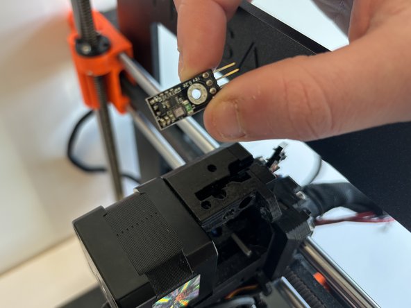

    • Locate the filament sensor.
    • Hold the filament sensor in place while unplugging the wiring connection.
    • Use caution because the wiring connections may be fragile.
    • Remove the filament sensor.
