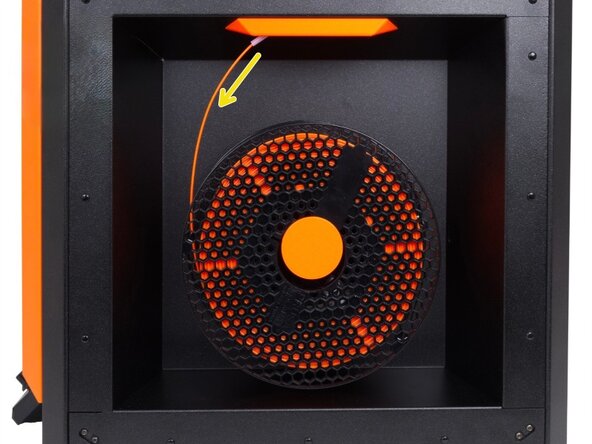

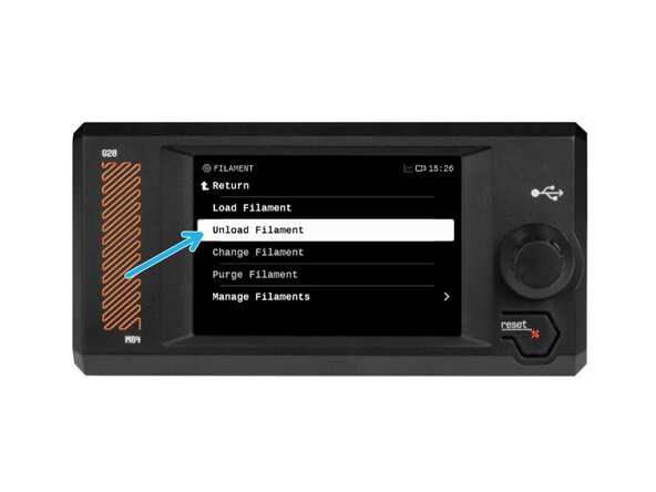

    • Close the printer's door.
    • Unload the filament via the printers Unload filament feature.
    • Remove the filament spool from the printer
    • Cool down the printer by navigating to Preheat, then Cooldown, and wait for the temprature to drop to the ambient temperature.
    • Ensure that the printer has cooled down completely before continuing.

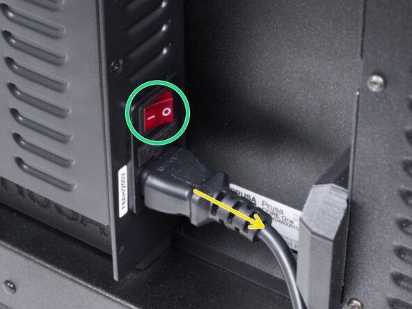

  2. Prusa CORE One Nozzle Replacement, Printer Preperation Continued: crwdns2935265:02crwdnd2935265:01crwdnd2935265:02crwdne2935265:0 Prusa CORE One Nozzle Replacement, Printer Preperation Continued: crwdns2935265:02crwdnd2935265:02crwdnd2935265:02crwdne2935265:0
    • Set your Z-Axis to 100 mm or more by going to Control, Move Axis then Move Z
    • Allow your printer's heatbed to move
    • Once the heatbed has finished moving, turn your printer off using the power switch on the back of the printer.
    • Remove the power cord from the printer to prevent the printer from being powered on accedently.

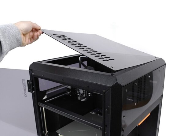

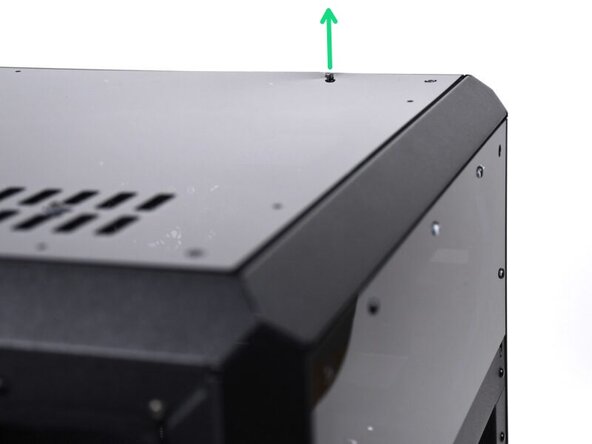

  3. Prusa CORE One Nozzle Replacement, Removing the Top Cover: crwdns2935265:03crwdnd2935265:01crwdnd2935265:03crwdne2935265:0 Prusa CORE One Nozzle Replacement, Removing the Top Cover: crwdns2935265:03crwdnd2935265:02crwdnd2935265:03crwdne2935265:0 Prusa CORE One Nozzle Replacement, Removing the Top Cover: crwdns2935265:03crwdnd2935265:03crwdnd2935265:03crwdne2935265:0
    • Remove the Top Cover of the printer by pushing the nylon rivets from the inside.
    • Once pushed out, the rivets can be removed from the outside.
    • Remove all the rivets using the same method detailed above.
    • Once all the rivits have been removed, the top cover of the printer can be removed.

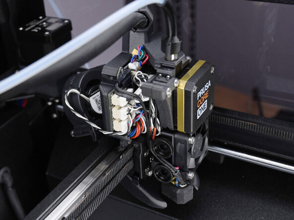

  5. Prusa CORE One Nozzle Replacement, Removing Nextruder Undercovering: crwdns2935265:05crwdnd2935265:01crwdnd2935265:02crwdne2935265:0 Prusa CORE One Nozzle Replacement, Removing Nextruder Undercovering: crwdns2935265:05crwdnd2935265:02crwdnd2935265:02crwdne2935265:0
    • Remove the two M3x10 screws holding the side over to the assembly.
    • Once the screws are removed, take the cover off your assembly.

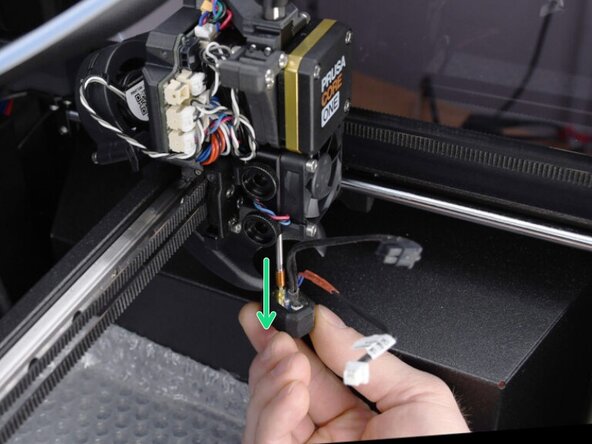

  6. Prusa CORE One Nozzle Replacement, Disconnecting Hotend Cables: crwdns2935265:06crwdnd2935265:01crwdnd2935265:02crwdne2935265:0 Prusa CORE One Nozzle Replacement, Disconnecting Hotend Cables: crwdns2935265:06crwdnd2935265:02crwdnd2935265:02crwdne2935265:0
    • Disconnect the cable for the Hotend Heater
    • Disconnect the cable for the Hotend Thermistor.
    • Each cable features a safety latch that holds each cable in its place. Be sure to press the latch before disconnecting to keep from damaging the connector.

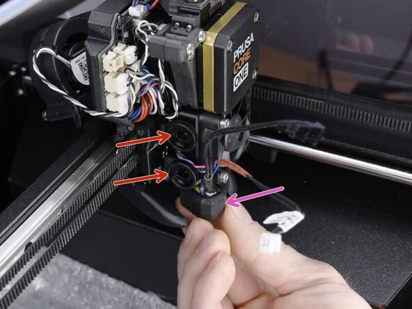

  7. Prusa CORE One Nozzle Replacement, Removing the Hotend Assembly: crwdns2935265:07crwdnd2935265:01crwdnd2935265:03crwdne2935265:0 Prusa CORE One Nozzle Replacement, Removing the Hotend Assembly: crwdns2935265:07crwdnd2935265:02crwdnd2935265:03crwdne2935265:0 Prusa CORE One Nozzle Replacement, Removing the Hotend Assembly: crwdns2935265:07crwdnd2935265:03crwdnd2935265:03crwdne2935265:0
    • Carefully unrout the disconnected hotend cables from the cable guide.
    • Grasp the Hotend with one hand.
    • With your free hand, loosen the two thumb screws holding the Hotend in place. Removing the thumb screws is not nessessary. A few turns is enough to get the Hotend free.
    • The Hotend will fall out if not held properly. Be sure you have your cloth protecting your Headbed.
    • Carefully slide the Hotend assembly out of the Heatsink.

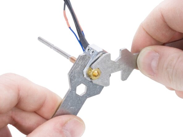

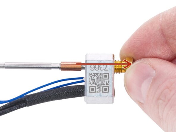

  8. Prusa CORE One Nozzle Replacement, Removing the Nozzle: crwdns2935265:08crwdnd2935265:01crwdnd2935265:03crwdne2935265:0 Prusa CORE One Nozzle Replacement, Removing the Nozzle: crwdns2935265:08crwdnd2935265:02crwdnd2935265:03crwdne2935265:0 Prusa CORE One Nozzle Replacement, Removing the Nozzle: crwdns2935265:08crwdnd2935265:03crwdnd2935265:03crwdne2935265:0
    • Remove the protective silicone sock from the heater block.
    • Use the 13 mm wrench to hold the heater block.
    • Use the 7 mm wrench to grasp and loosen the nozzle from the heater block.
    • Once loosened you can manually unscrew, and slide the nozzle out from the heater block.
Once the nozzle has been removed you can install a new nozzle by reversing these steps. During reassembly keep the following in mind...
  • When tighten the nozzle against the heater block. Avoid applying excessive force. The specific torque value is 1.5 Nm (13.3 lb-in). The use of a torque wrench is recommended.
  • When reinsterting the Hotend into the heatsink, the bottom of the Hotend should align with the bottom of the Fan Shroud. Do not allow the Hotend to protrude below the Fan Shroud. You can verify that the nozzle is fully inserted by making sure that the copper ring on the nozzle should not be visible.
