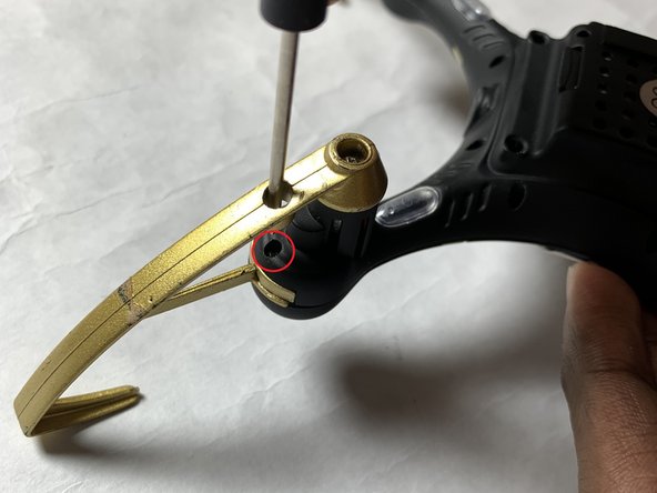

    • Use the Phillips #0 screwdriver to remove eight propeller guard screws.

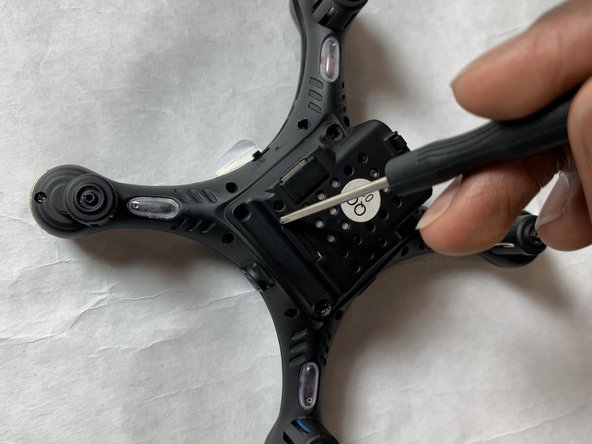

    • Use the Phillips #0 screwdriver to remove eight housing screws from the bottom of the drone.

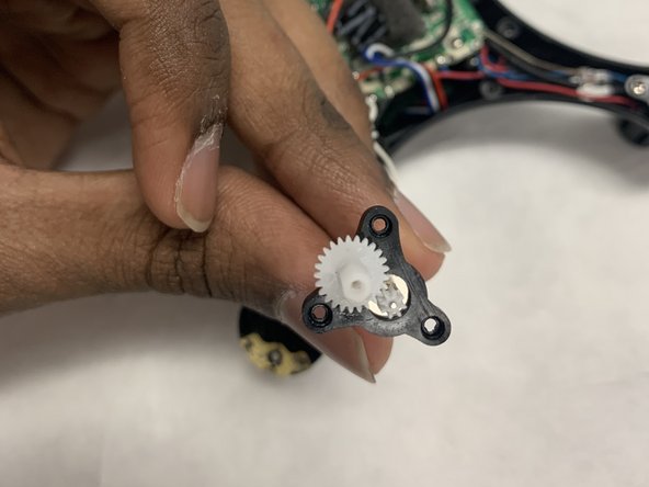

    • Use the Phillips #0 screwdriver to remove three motor housing screws. There are three screws per motor.
    • The plastic housing is glued directly to motor.

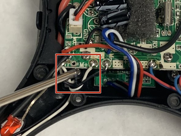

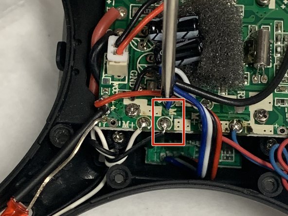

    • Desolder the wires connecting the propeller motor to the motherboard (2 per motor) and remove the motor from the device.
