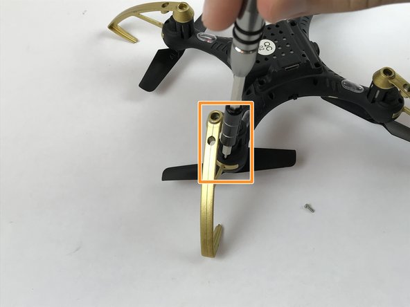

    • Make sure the drone is powered off.
    • Turn the drone over.
  2. Protocol Videodrone AP Propeller Guards Replacement: crwdns2935265:02crwdnd2935265:01crwdnd2935265:01crwdne2935265:0
    • Unscrew the top four screws using a Phillips #0 screwdriver.
  3. Protocol Videodrone AP Propeller Guards Replacement: crwdns2935265:03crwdnd2935265:01crwdnd2935265:02crwdne2935265:0 Protocol Videodrone AP Propeller Guards Replacement: crwdns2935265:03crwdnd2935265:02crwdnd2935265:02crwdne2935265:0
    • Unscrew the four secondary screws using the Phillips #0 screwdriver.
    • If the screwdriver does not fit in the guard hole, lift and move the guard to the side and unscrew.
