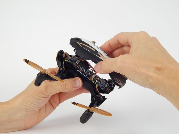

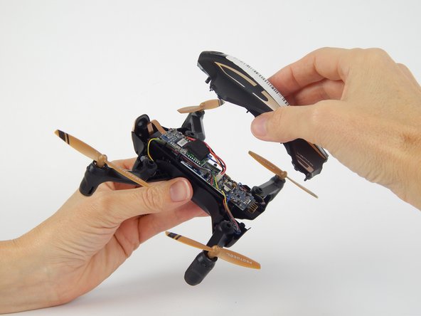

  4. Protocol Vento Wi-Fi Antenna Replacement: crwdns2935265:04crwdnd2935265:01crwdnd2935265:03crwdne2935265:0 Protocol Vento Wi-Fi Antenna Replacement: crwdns2935265:04crwdnd2935265:02crwdnd2935265:03crwdne2935265:0 Protocol Vento Wi-Fi Antenna Replacement: crwdns2935265:04crwdnd2935265:03crwdnd2935265:03crwdne2935265:0
    • Flip the drone over and lift off the top plastic shell of the drone.

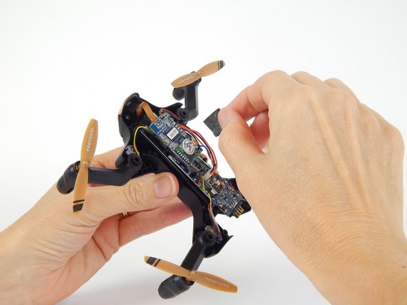

  5. Protocol Vento Wi-Fi Antenna Replacement: crwdns2935265:05crwdnd2935265:01crwdnd2935265:02crwdne2935265:0 Protocol Vento Wi-Fi Antenna Replacement: crwdns2935265:05crwdnd2935265:02crwdnd2935265:02crwdne2935265:0
    • Remove the foam adhesive pad located on the Wi-Fi transmitter board.

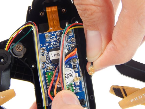

    • Pry the gold Wi-Fi antenna connector, located under the previously removed foam pad, away from the Wi-Fi transmitter board to disconnect it.
    • Be sure to only apply force to the gold connector and not the black wire attached to it, as the connection between the two is very fragile.

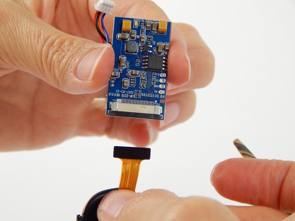

  8. Protocol Vento Wi-Fi Antenna Replacement: crwdns2935265:08crwdnd2935265:01crwdnd2935265:01crwdne2935265:0
    • Disconnect the white clip that connects the four colored wires (black, orange, red, blue) to the motherboard.
    • Be sure to pull only on the white clip, as to avoid damaging the wires.
  9. Protocol Vento Wi-Fi Antenna Replacement: crwdns2935265:09crwdnd2935265:01crwdnd2935265:02crwdne2935265:0 Protocol Vento Wi-Fi Antenna Replacement: crwdns2935265:09crwdnd2935265:02crwdnd2935265:02crwdne2935265:0
    • Gently pull the black wedge away from the main board until it shifts to a stop. You will feel it slide out, then stop.
    • The black insert acts as a wedge to keep the ribbon cable attached to the board. The wedge needs to be jostled loose before the cable can be removed.
    • Lightly pull the ribbon cable away from the connector.

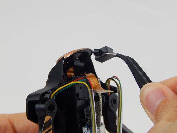

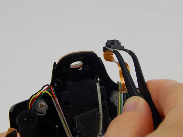

  10. Protocol Vento Wi-Fi Antenna Replacement, Front Camera: crwdns2935265:010crwdnd2935265:01crwdnd2935265:01crwdne2935265:0
    • Remove the two 4.9mm Phillips #000 screws securing the camera to the front of the drone body.
  11. Protocol Vento Wi-Fi Antenna Replacement: crwdns2935265:011crwdnd2935265:01crwdnd2935265:03crwdne2935265:0 Protocol Vento Wi-Fi Antenna Replacement: crwdns2935265:011crwdnd2935265:02crwdnd2935265:03crwdne2935265:0 Protocol Vento Wi-Fi Antenna Replacement: crwdns2935265:011crwdnd2935265:03crwdnd2935265:03crwdne2935265:0
    • Lift the camera holder and the camera up and away from the drone.

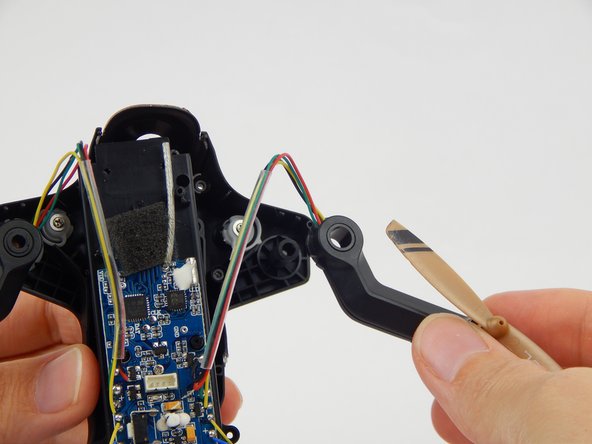

  13. Protocol Vento Wi-Fi Antenna Replacement: crwdns2935265:013crwdnd2935265:01crwdnd2935265:02crwdne2935265:0 Protocol Vento Wi-Fi Antenna Replacement: crwdns2935265:013crwdnd2935265:02crwdnd2935265:02crwdne2935265:0
    • Grasp and pull each of the four drone arms in the direction of their propellers, one at a time, to remove them from the drone.
  14. Protocol Vento Wi-Fi Antenna Replacement: crwdns2935265:014crwdnd2935265:01crwdnd2935265:01crwdne2935265:0
    • Gently pull the motherboard out of the drone.
    • The four arms of the drone will dangle from the motherboard by their cords.

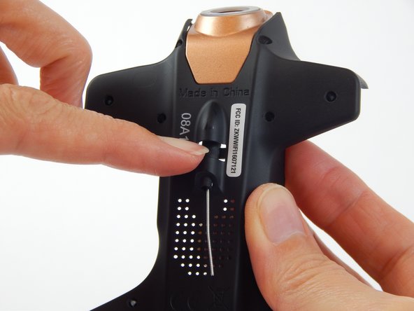

  16. Protocol Vento Wi-Fi Antenna Replacement: crwdns2935265:016crwdnd2935265:01crwdnd2935265:02crwdne2935265:0 Protocol Vento Wi-Fi Antenna Replacement: crwdns2935265:016crwdnd2935265:02crwdnd2935265:02crwdne2935265:0
    • Hold the drone’s shell with both hands so that the inside of the shell is facing you.
    • Gently flex the shell outward, so that the two latches (holding the antenna in place) move apart slightly.
    • At the same time, push the antenna from the back of the drone towards you until it releases from the latches.
