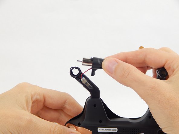

  6. Protocol Vento Motor Replacement: crwdns2935265:06crwdnd2935265:01crwdnd2935265:02crwdne2935265:0 Protocol Vento Motor Replacement: crwdns2935265:06crwdnd2935265:02crwdnd2935265:02crwdne2935265:0
    • Hold the base of the arm while gently pulling the motor cover away from the arm.
    • Do not pull too hard because there are wires attaching the motor to the drone. Do not sever the wires.

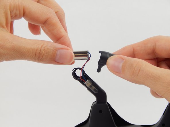

  7. Protocol Vento Motor Replacement: crwdns2935265:07crwdnd2935265:01crwdnd2935265:02crwdne2935265:0 Protocol Vento Motor Replacement: crwdns2935265:07crwdnd2935265:02crwdnd2935265:02crwdne2935265:0
    • Gently pull the motor out from the plastic cover.
    • Do not squeeze or pull too hard, as to not damage the motor connection.

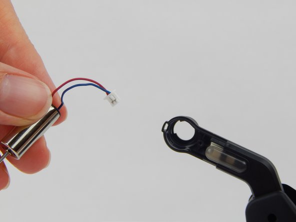

  8. Protocol Vento Motor Replacement: crwdns2935265:08crwdnd2935265:01crwdnd2935265:02crwdne2935265:0 Protocol Vento Motor Replacement: crwdns2935265:08crwdnd2935265:02crwdnd2935265:02crwdne2935265:0
    • The motor’s blue and red wires are secured via a white clip. This clip is inserted into a slot in the drone’s leg.
    • Grasp the clip’s edges with a pair of tweezers and pull outward.
    • Do not pull directly on the wires, as to not separate the wires from the clip.
