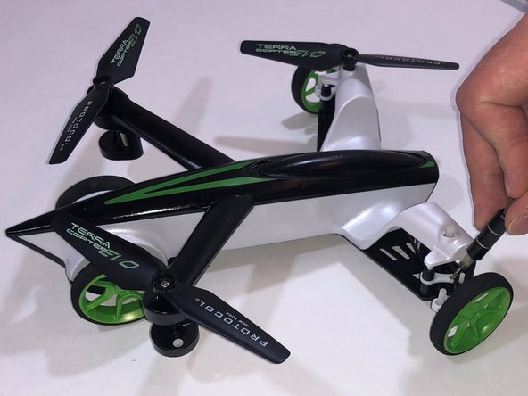

    • Using a Phillips #0 screwdriver, remove the four screws connecting the propellers to the device.

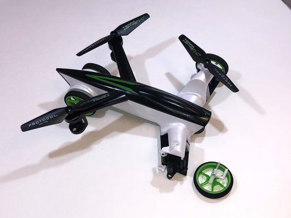

    • Hold the propellers gently and pull the propellers out of the drone .

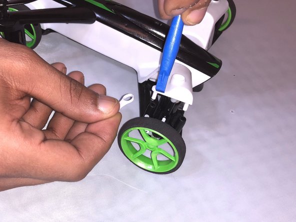

    • Use a plastic opening tool or a spudger to separate the drone's cover from the body of the drone.
    • Remove the connector of the drone body and the back wheels using a plastic opening tool.

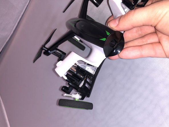

    • Use the opening tool to separate the drone's body from the drone's shock absorber.
  5. Protocol TerraCopter EVO Front Wheels Replacement: crwdns2935265:05crwdnd2935265:01crwdnd2935265:03crwdne2935265:0 Protocol TerraCopter EVO Front Wheels Replacement: crwdns2935265:05crwdnd2935265:02crwdnd2935265:03crwdne2935265:0 Protocol TerraCopter EVO Front Wheels Replacement: crwdns2935265:05crwdnd2935265:03crwdnd2935265:03crwdne2935265:0

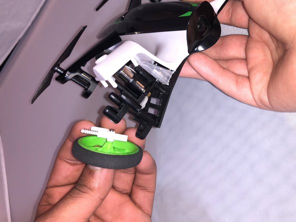

    • Hold the wheels gently then pull it out of the drone's lower board wheels connector.
    • Repeat the same step for the other front wheel.
