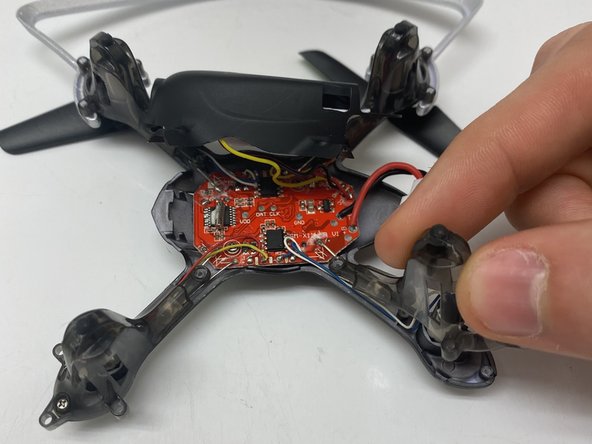

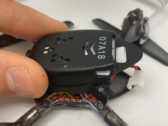

  4. Protocol Slipstream WiFi Propeller Motor Replacement, Propeller Motor: crwdns2935265:04crwdnd2935265:01crwdnd2935265:02crwdne2935265:0 Protocol Slipstream WiFi Propeller Motor Replacement, Propeller Motor: crwdns2935265:04crwdnd2935265:02crwdnd2935265:02crwdne2935265:0
    • Remove the four 5.5 mm Philips #00 screws that hold the lower canopy to the upper canopy.
    • Gently pull the lower canopy up and towards the back of the drone. The lower canopy will still be attached to the upper canopy by 3 wires. Just set the lower canopy aside and continue with the repair.
    • Be very careful when pulling the lower canopy apart from the upper canopy. There are 3 wires that will still be attached between the lower and upper canopies.

  6. Protocol Slipstream WiFi Propeller Motor Replacement: crwdns2935265:06crwdnd2935265:01crwdnd2935265:02crwdne2935265:0 Protocol Slipstream WiFi Propeller Motor Replacement: crwdns2935265:06crwdnd2935265:02crwdnd2935265:02crwdne2935265:0
    • Grab the motor and pull the motor out of the upper canopy slot.
    • Be careful pulling the motor out of the slot in the upper canopy. The motor will still be attached to the main computer by 2 wires.
  7. Protocol Slipstream WiFi Propeller Motor Replacement: crwdns2935265:07crwdnd2935265:01crwdnd2935265:01crwdne2935265:0
    • At this point, pay attention to where each color wire attaches to the computer. Write down which color wire goes where.
    • It is very important that you connect the new motor wires in the same location as the old wires and pay attention to which color wire attaches to each location.
