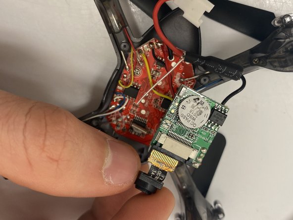

  3. Protocol Slipstream WiFi Camera Replacement: crwdns2935265:03crwdnd2935265:01crwdnd2935265:01crwdne2935265:0
    • Use a spudger to gently pry around the outside edge of the camera to remove the camera from its mounting hole.
    • Be careful when removing the camera from its mounting hole as there is a small ribbon wire that connects it to the computer.
    • The camera and computer assembly will now be free to move. Move the lower canopy out of the way for now.

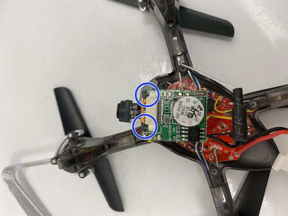

  4. Protocol Slipstream WiFi Camera Replacement: crwdns2935265:04crwdnd2935265:01crwdnd2935265:03crwdne2935265:0 Protocol Slipstream WiFi Camera Replacement: crwdns2935265:04crwdnd2935265:02crwdnd2935265:03crwdne2935265:0 Protocol Slipstream WiFi Camera Replacement: crwdns2935265:04crwdnd2935265:03crwdnd2935265:03crwdne2935265:0
    • Use the flat side of the spudger and push the 2 tabs on either side of the camera connection on the computer and push the tabs towards the front of the drone (away from the computer).
    • Make sure both tabs are all the way out otherwise the ribbon wire for the camera will not be free and you can damage the wire by pulling on it.
    • Now remove the camera ribbon wire from the camera connection on the computer.
