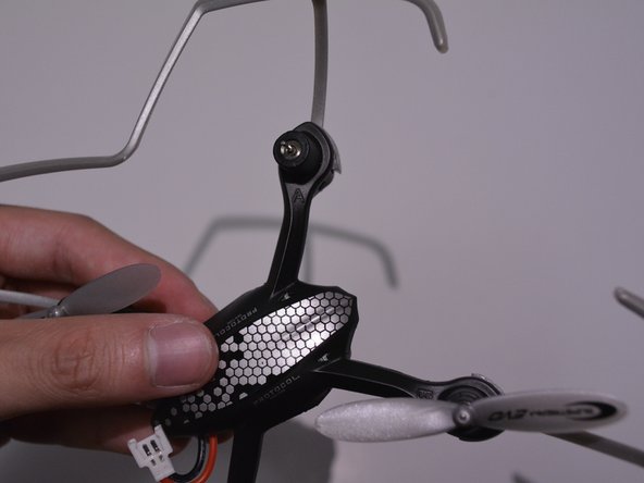

    • With the drone flat on the ground identify which propeller you will be replacing.

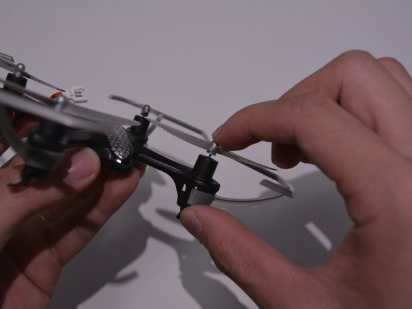

  2. Protocol Slipstream EVO Propeller blades Replacement: crwdns2935265:02crwdnd2935265:01crwdnd2935265:02crwdne2935265:0 Protocol Slipstream EVO Propeller blades Replacement: crwdns2935265:02crwdnd2935265:02crwdnd2935265:02crwdne2935265:0
    • Using two fingers, place them on each side of the propellor near the middle.
    • Pull straight up with force. The propellor will feel as if it will not come off but do not be scared to use some muscle.
    • Warning: Pulling at an angle will result in bending the motor's needle.
  3. Protocol Slipstream EVO Propeller blades Replacement: crwdns2935265:03crwdnd2935265:01crwdnd2935265:03crwdne2935265:0 Protocol Slipstream EVO Propeller blades Replacement: crwdns2935265:03crwdnd2935265:02crwdnd2935265:03crwdne2935265:0 Protocol Slipstream EVO Propeller blades Replacement: crwdns2935265:03crwdnd2935265:03crwdnd2935265:03crwdne2935265:0
    • Checking the underside of the propeller there will be a letter which will correspond with each side of the drone
    • On the corner of the drone where the blade mounts onto the motor you will see which blade you should be using.
    • Warning: Failure to match the propeller blade to the right motor may result in the drone not flying.
    • Lining up the propeller blade with the needle, push down until the propeller is flushed.
