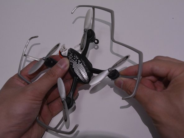

    • With the drone flat on the ground, identify which propeller guard you will be replacing.
    • The front of the drone is where there are no wires exposed.
  2. Protocol Slipstream EVO Propeller Guards Replacement: crwdns2935265:02crwdnd2935265:01crwdnd2935265:02crwdne2935265:0 Protocol Slipstream EVO Propeller Guards Replacement: crwdns2935265:02crwdnd2935265:02crwdnd2935265:02crwdne2935265:0
    • With the plastic opening tool, pry the side of the guard closest to the front or the back of the drone depending on where you decided to start from.
    • After prying off one side of the guard, pushing down on the same side will release the other side of the clip.
    • Repeat this step for the following side as needed.
  3. Protocol Slipstream EVO Propeller Guards Replacement: crwdns2935265:03crwdnd2935265:01crwdnd2935265:02crwdne2935265:0 Protocol Slipstream EVO Propeller Guards Replacement: crwdns2935265:03crwdnd2935265:02crwdnd2935265:02crwdne2935265:0
    • With the replacement guard line up the clips and push the clips into place.
    • After the guard has been attached to the drone, pinch the clips as you push the guards to ensure they are secured.
