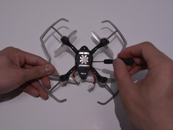

    • On the bottom of the drone unscrew the screws next to the battery, using the screwdriver provided.
    • The picture shows one of the screws you will be removing, the other screw is directly across from the one being presented.
    • Tip: Removing the screws will loosen the frame of the drone allowing the battery to be removed easier. If you do not want to remove the screws skip to step 2.

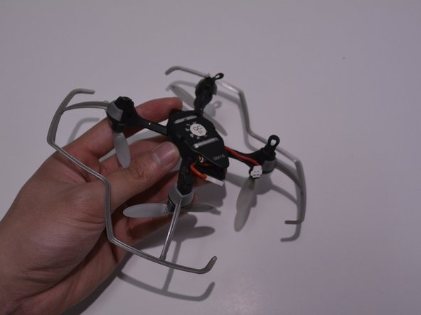

    • Pinch the side of the battery that is already exposed and pull until the battery is fully removed from the drone.
