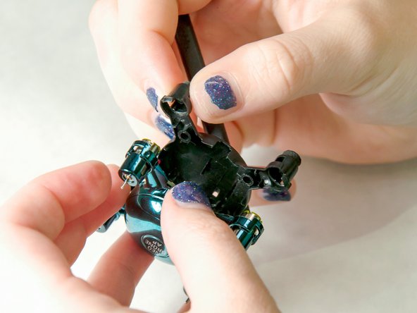

    • Remove the four 4.5mm Phillips #0 screws from the back panel.
  4. Protocol Neo-Drone AP Motor Replacement: crwdns2935265:04crwdnd2935265:01crwdnd2935265:02crwdne2935265:0 Protocol Neo-Drone AP Motor Replacement: crwdns2935265:04crwdnd2935265:02crwdnd2935265:02crwdne2935265:0
    • Use the flat end of a spudger to pry apart the the two pieces.
    • Lift the back panel up to separate it from the front panel.
  5. Protocol Neo-Drone AP Motor Replacement: crwdns2935265:05crwdnd2935265:01crwdnd2935265:01crwdne2935265:0
    • Pull the four motors out of the case.
    • The motors are still soldered to the motherboard.
