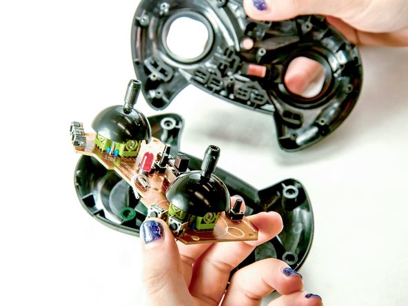

  2. Protocol Neo-Drone AP Controller Switch Replacement: crwdns2935265:02crwdnd2935265:01crwdnd2935265:02crwdne2935265:0 Protocol Neo-Drone AP Controller Switch Replacement: crwdns2935265:02crwdnd2935265:02crwdnd2935265:02crwdne2935265:0
    • Remove seven 6.5mm Phillips #1 screws from the back panel.
    • Pull the back panel up to separate it from the front panel.
  3. Protocol Neo-Drone AP Controller Switch Replacement: crwdns2935265:03crwdnd2935265:01crwdnd2935265:02crwdne2935265:0 Protocol Neo-Drone AP Controller Switch Replacement: crwdns2935265:03crwdnd2935265:02crwdnd2935265:02crwdne2935265:0
    • Remove three 4.5mm Phillips #1 screws from the motherboard.
    • Pull the motherboard out of the case.

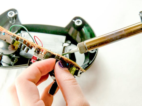

    • Here is a link to the iFixit Soldering Guide
    • Use a soldering iron to remove the solder form the motherboard.
