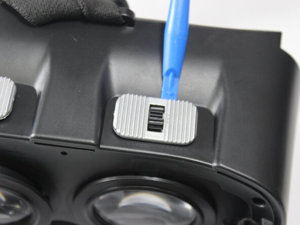

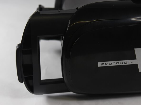

    • Remove the phone slide from the virtual reality goggles.
    • Take the outside cover off using the plastic opening tool.

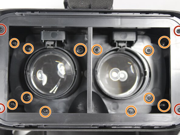

    • Remove each screw from its place.
    • Remove four 6mm Phillips head screws.
    • Remove twelve 7mm Phillips head screws.

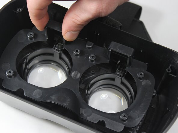

    • Pull out each bracket so you can see the full lens case.

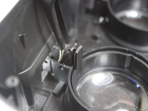

  3. Protocol Kaptur GPS Virtual Reality Lens Replacement: crwdns2935265:03crwdnd2935265:01crwdnd2935265:03crwdne2935265:0 Protocol Kaptur GPS Virtual Reality Lens Replacement: crwdns2935265:03crwdnd2935265:02crwdnd2935265:03crwdne2935265:0 Protocol Kaptur GPS Virtual Reality Lens Replacement: crwdns2935265:03crwdnd2935265:03crwdnd2935265:03crwdne2935265:0

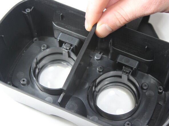

    • Remove the adjustable lens lever on top of the virtual reality lens.
    • Using tweezers, you will need to separate the tooth gears and remove them so the lens can fall freely out.

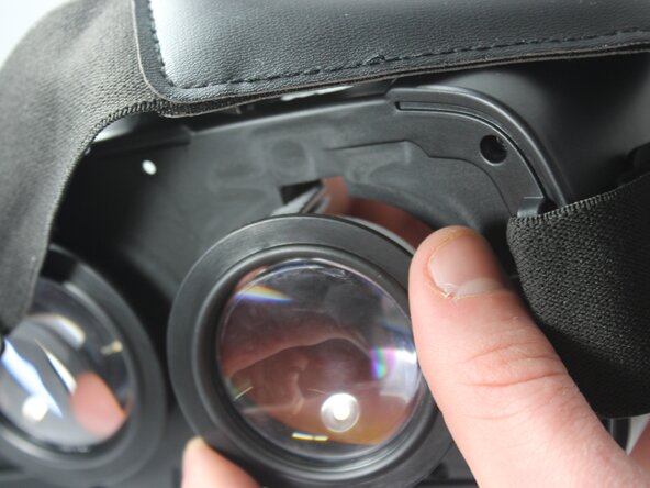

    • Pull the lens case out from the front of the headset.
  4. Protocol Kaptur GPS Virtual Reality Lens Replacement: crwdns2935265:04crwdnd2935265:01crwdnd2935265:02crwdne2935265:0 Protocol Kaptur GPS Virtual Reality Lens Replacement: crwdns2935265:04crwdnd2935265:02crwdnd2935265:02crwdne2935265:0

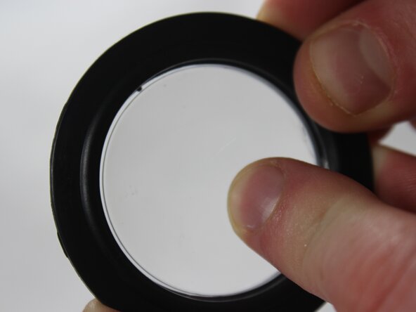

    • With a little force, push the lens from outside in to break the lens out of the case. This will get the lens out.
    • Now replace the lens with a new one and follow the steps in reverse order to put the lens back!
