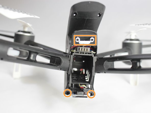

    • The battery is accessible through the back of the drone.
    • Press the tabs on both sides of the white stripe to pull the battery out.

    • Remove the screws starting with the three smaller ones on the top part of the battery.
    • Remove the three screws on the other side.
    • There are two screws tucked under where the yellow circle is located. You will need to remove the other screws first before you get to these two.
    • There should be one 7 mm Phillips head screw, three 6 mm Phillips head screws, and four 5 mm Phillips head screws.

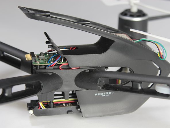

  5. Protocol Kaptur GPS Main Circuit Board Replacement, Main Circuit Board: crwdns2935265:05crwdnd2935265:01crwdnd2935265:02crwdne2935265:0 Protocol Kaptur GPS Main Circuit Board Replacement, Main Circuit Board: crwdns2935265:05crwdnd2935265:02crwdnd2935265:02crwdne2935265:0
    • Remove the 4x 7mm screws on the top and bottom, and the 2x 5mm screws from the middle, then remove the back part of the housing.
    • Remove the two hidden screws at the bottom, and the white power button.
    • There will be 6x 7 mm Phillips head screws, and 2x 5 mm Phillips head screws.

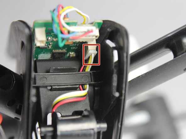

  6. Protocol Kaptur GPS Main Circuit Board Replacement: crwdns2935265:06crwdnd2935265:01crwdnd2935265:03crwdne2935265:0 Protocol Kaptur GPS Main Circuit Board Replacement: crwdns2935265:06crwdnd2935265:02crwdnd2935265:03crwdne2935265:0 Protocol Kaptur GPS Main Circuit Board Replacement: crwdns2935265:06crwdnd2935265:03crwdnd2935265:03crwdne2935265:0
    • Unplug all the cords from the circuit boards.
    • Carefully slide the main body right off the arms.

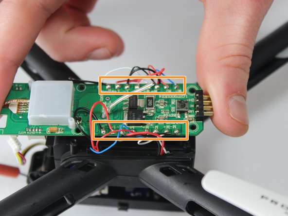

  7. Protocol Kaptur GPS Main Circuit Board Replacement: crwdns2935265:07crwdnd2935265:01crwdnd2935265:02crwdne2935265:0 Protocol Kaptur GPS Main Circuit Board Replacement: crwdns2935265:07crwdnd2935265:02crwdnd2935265:02crwdne2935265:0
    • Remove the four 4mm Phillips screws.
    • Desolder all cords on the circuit board, and pull the board up and out.
    • It is important to keep track of where the leads came from. Red/Blue and Black/White pairings belong to motors, whereas Black/Red pairings belong to lights. The ports are labeled on the board.
