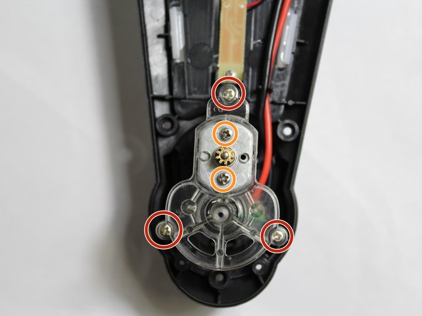

  7. Protocol Galileo Stealth Motor Replacement, Motor: crwdns2935265:07crwdnd2935265:01crwdnd2935265:02crwdne2935265:0 Protocol Galileo Stealth Motor Replacement, Motor: crwdns2935265:07crwdnd2935265:02crwdnd2935265:02crwdne2935265:0
    • Remove the 3 outer 8mm long Phillips #0 screws from the lower drone housing.
    • Remove the 2 inner 3 mm long Phillips #0 screws from the drone motor.
    • Place screws in a safe place to prevent misplacing them.

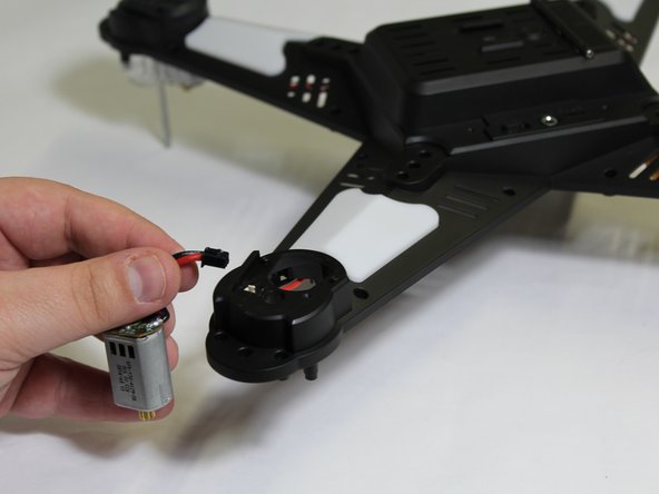

  10. Protocol Galileo Stealth Motor Replacement: crwdns2935265:010crwdnd2935265:01crwdnd2935265:02crwdne2935265:0 Protocol Galileo Stealth Motor Replacement: crwdns2935265:010crwdnd2935265:02crwdnd2935265:02crwdne2935265:0
    • Unclip the wire plug by applying light pressure to the wire plug with the plastic opening tool, and remove the motor.
    • This plug can be a bit difficult to remove, but it does not require much force to remove.
    • Avoid damaging the plug and wires when unclipping wire plug.
