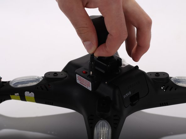

    • Find door on the underside of drone. Open the door.
  2. Protocol Galileo Motor Replacement: crwdns2935265:02crwdnd2935265:01crwdnd2935265:02crwdne2935265:0 Protocol Galileo Motor Replacement: crwdns2935265:02crwdnd2935265:02crwdnd2935265:02crwdne2935265:0
    • Carefully pull out battery, pulling out wires first.
  3. Protocol Galileo Motor Replacement: crwdns2935265:03crwdnd2935265:01crwdnd2935265:01crwdne2935265:0
    • Disconnect the connecter.
    • When reconnecting, remember to match up the black wire with the black wire and the red with red.

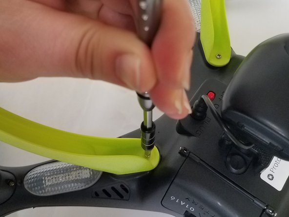

  9. Protocol Galileo Motor Replacement, Top Shell: crwdns2935265:09crwdnd2935265:01crwdnd2935265:03crwdne2935265:0 Protocol Galileo Motor Replacement, Top Shell: crwdns2935265:09crwdnd2935265:02crwdnd2935265:03crwdne2935265:0 Protocol Galileo Motor Replacement, Top Shell: crwdns2935265:09crwdnd2935265:03crwdnd2935265:03crwdne2935265:0
    • Remove Blade Guards by unscrewing two 13 millimeter screws using Philips #0. Pull out the guards. Repeat the steps for the other three corners.

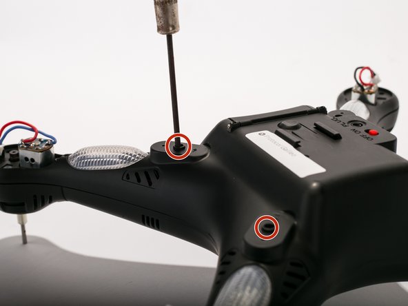

  10. Protocol Galileo Motor Replacement: crwdns2935265:010crwdnd2935265:01crwdnd2935265:02crwdne2935265:0 Protocol Galileo Motor Replacement: crwdns2935265:010crwdnd2935265:02crwdnd2935265:02crwdne2935265:0
    • Unscrew two 9 mm screws located inside the legs. Repeat the same procedure for the other three legs

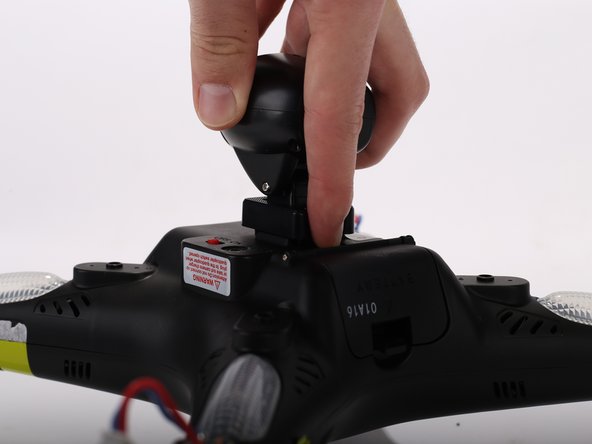

    • Unplug the camera wire.
    • Press the hold release button and slide out the camera module away from the button.

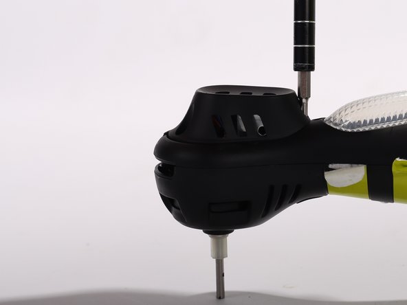

  12. Protocol Galileo Motor Replacement: crwdns2935265:012crwdnd2935265:01crwdnd2935265:02crwdne2935265:0 Protocol Galileo Motor Replacement: crwdns2935265:012crwdnd2935265:02crwdnd2935265:02crwdne2935265:0
    • Remove the motor protection cover by unscrewing two 9 mm screws using Philips #0. When the screws are off, use your fingers to pull the motor protection cover off. Repeat the procedure for the other three arms.

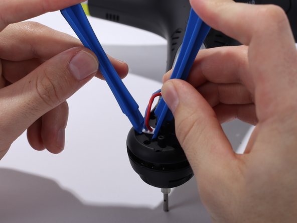

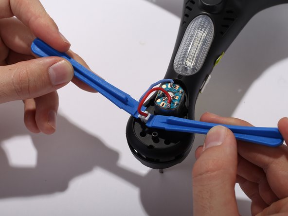

  13. Protocol Galileo Motor Replacement: crwdns2935265:013crwdnd2935265:01crwdnd2935265:03crwdne2935265:0 Protocol Galileo Motor Replacement: crwdns2935265:013crwdnd2935265:02crwdnd2935265:03crwdne2935265:0 Protocol Galileo Motor Replacement: crwdns2935265:013crwdnd2935265:03crwdnd2935265:03crwdne2935265:0
    • Unclip the motor cable from the shells housing using two pry tools. Repeat the same procedure for the other three arms.

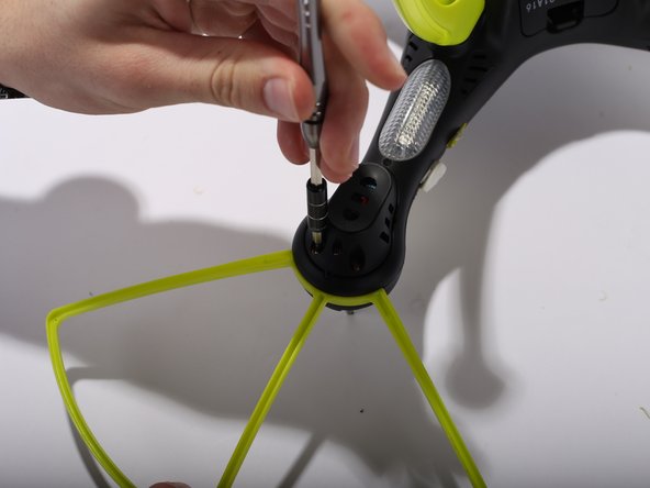

  14. Protocol Galileo Motor Replacement: crwdns2935265:014crwdnd2935265:01crwdnd2935265:01crwdne2935265:0
    • Remove 3 9mm screws around the motor housing. Repeat the steps for the three other arms.

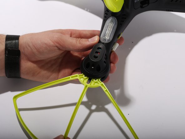

  15. Protocol Galileo Motor Replacement: crwdns2935265:015crwdnd2935265:01crwdnd2935265:02crwdne2935265:0 Protocol Galileo Motor Replacement: crwdns2935265:015crwdnd2935265:02crwdnd2935265:02crwdne2935265:0
    • Remove four 9 mm screws located where the legs originally are placed. (Use a thin head screwdriver)

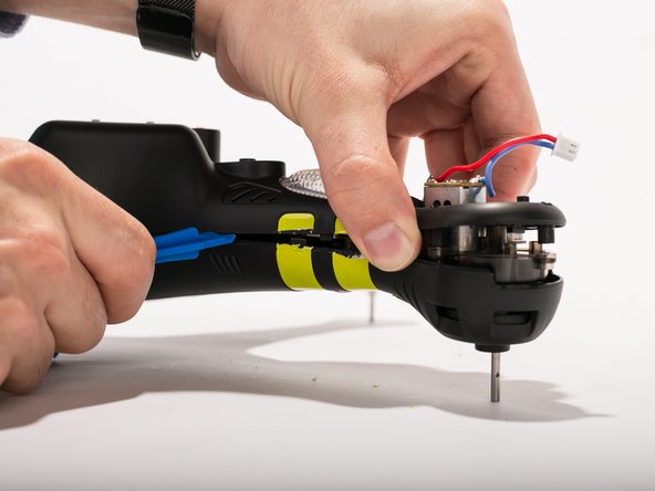

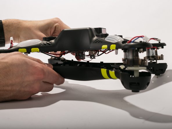

  16. Protocol Galileo Motor Replacement: crwdns2935265:016crwdnd2935265:01crwdnd2935265:03crwdne2935265:0 Protocol Galileo Motor Replacement: crwdns2935265:016crwdnd2935265:02crwdnd2935265:03crwdne2935265:0 Protocol Galileo Motor Replacement: crwdns2935265:016crwdnd2935265:03crwdnd2935265:03crwdne2935265:0
    • Cut the yellow strips using a scalpel. Pry open the casing using pry tools working gently around the corners.
  17. Protocol Galileo Motor Replacement, Pinion Gear: crwdns2935265:017crwdnd2935265:01crwdnd2935265:01crwdne2935265:0
    • Remove the motor assembly from the bottom shell.

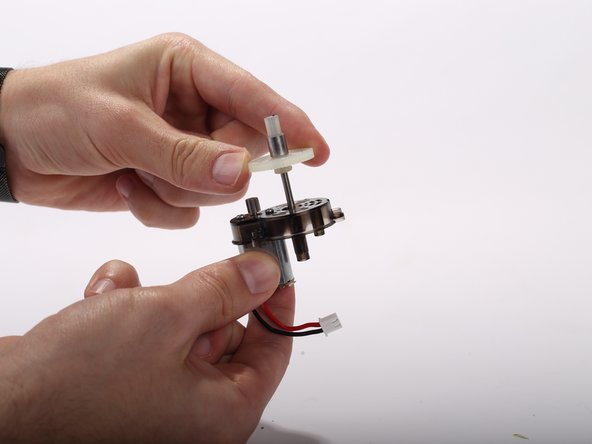

  18. Protocol Galileo Motor Replacement: crwdns2935265:018crwdnd2935265:01crwdnd2935265:02crwdne2935265:0 Protocol Galileo Motor Replacement: crwdns2935265:018crwdnd2935265:02crwdnd2935265:02crwdne2935265:0
    • Slide the pinion gear off of the motor assembly.

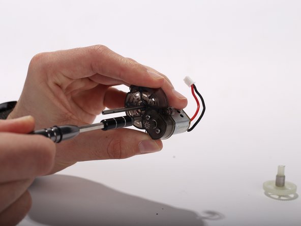

  19. Protocol Galileo Motor Replacement, Motor: crwdns2935265:019crwdnd2935265:01crwdnd2935265:02crwdne2935265:0 Protocol Galileo Motor Replacement, Motor: crwdns2935265:019crwdnd2935265:02crwdnd2935265:02crwdne2935265:0
    • Remove the two 4mm Philips screws from the motor.
    • Separate the motor from the plastic motor holder.
