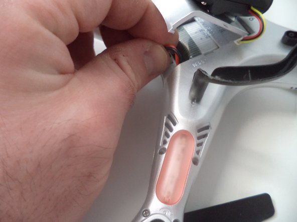

This guide is for replacing the rechargeable battery in the Protocol Dronium Two. This repair doesn't require tools. A spare battery is not included in the packaging but can be bought from the Protocol store.
  1. Protocol Dronium Two Rechargeable Battery Replacement, Rechargeable Battery: crwdns2935265:01crwdnd2935265:01crwdnd2935265:01crwdne2935265:0
    • Turn the drone off by moving the selector switch to the left.
  2. Protocol Dronium Two Rechargeable Battery Replacement: crwdns2935265:02crwdnd2935265:01crwdnd2935265:01crwdne2935265:0
    • On the underside of the drone, gently pull the battery compartment away from the drone.
    • Press down on the camera as shown to get a better grip.
  3. Protocol Dronium Two Rechargeable Battery Replacement: crwdns2935265:03crwdnd2935265:01crwdnd2935265:02crwdne2935265:0 Protocol Dronium Two Rechargeable Battery Replacement: crwdns2935265:03crwdnd2935265:02crwdnd2935265:02crwdne2935265:0
    • If the power cable of the battery is connected to the drone, remove it by gently pulling it out.
  4. Protocol Dronium Two Rechargeable Battery Replacement: crwdns2935265:04crwdnd2935265:01crwdnd2935265:01crwdne2935265:0
    • Remove the battery from its compartment by sliding it out away from the drone.
