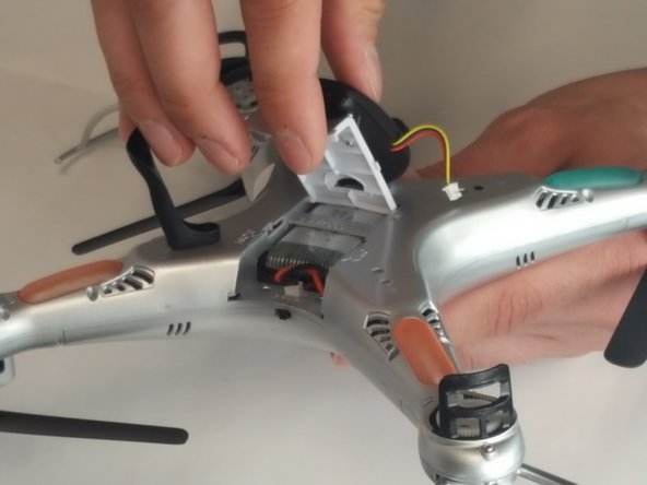

  3. Protocol Dronium Two HD Camera Replacement, HD Camera: crwdns2935265:03crwdnd2935265:01crwdnd2935265:02crwdne2935265:0 Protocol Dronium Two HD Camera Replacement, HD Camera: crwdns2935265:03crwdnd2935265:02crwdnd2935265:02crwdne2935265:0
    • Use the fine edged plastic opening tool to pull up one side of the plug, and then the other, until it comes loose.
  4. Protocol Dronium Two HD Camera Replacement: crwdns2935265:04crwdnd2935265:01crwdnd2935265:02crwdne2935265:0 Protocol Dronium Two HD Camera Replacement: crwdns2935265:04crwdnd2935265:02crwdnd2935265:02crwdne2935265:0
    • Push the battery cover away from the drone and carefully open it up.

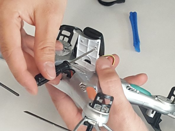

  5. Protocol Dronium Two HD Camera Replacement: crwdns2935265:05crwdnd2935265:01crwdnd2935265:02crwdne2935265:0 Protocol Dronium Two HD Camera Replacement: crwdns2935265:05crwdnd2935265:02crwdnd2935265:02crwdne2935265:0
    • Carefully remove the two Phillips 5.35 mm screws holding the camera to the battery cover.
  6. Protocol Dronium Two HD Camera Replacement: crwdns2935265:06crwdnd2935265:01crwdnd2935265:01crwdne2935265:0
    • Close the battery cover by pulling it towards you. Then, gently pull the camera towards you, freeing it from the battery cover.
