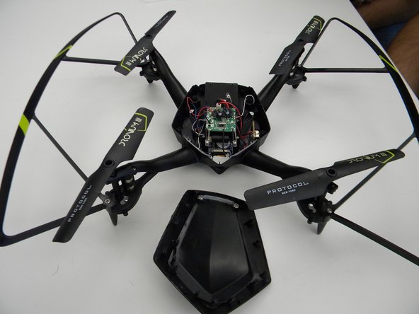

  5. Protocol Dronium III AP Light Bulb Replacement: crwdns2935265:05crwdnd2935265:01crwdnd2935265:02crwdne2935265:0 Protocol Dronium III AP Light Bulb Replacement: crwdns2935265:05crwdnd2935265:02crwdnd2935265:02crwdne2935265:0
    • Remove the six (6) 5mm Philips screws attaching the Body Cover to the Body of the drone using a Philips J00 screwdriver.
    • Remove the Body Cover.

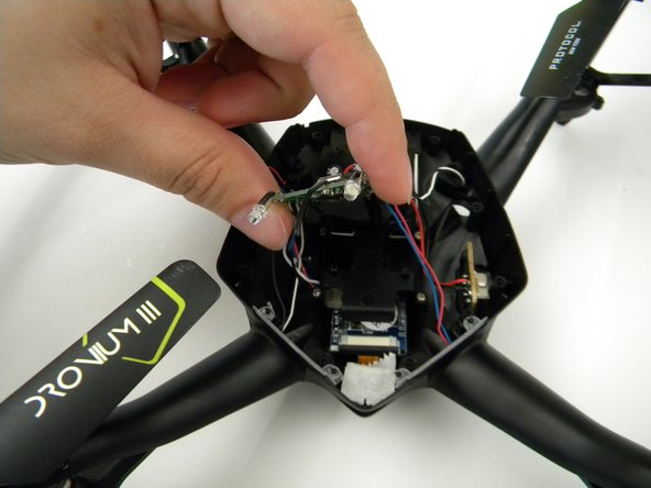

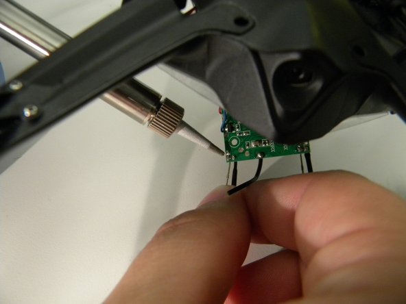

  7. Protocol Dronium III AP Light Bulb Replacement: crwdns2935265:07crwdnd2935265:01crwdnd2935265:02crwdne2935265:0 Protocol Dronium III AP Light Bulb Replacement: crwdns2935265:07crwdnd2935265:02crwdnd2935265:02crwdne2935265:0
    • This step contains a tool that can present a potential burn hazard.
    • Prepare and warm up a soldering iron.
    • Position Motherboard so that the L.E.D. bulb solder joints are accessible.
    • Use the soldering iron to melt the solder joints.
    • For more detailed instructions on how to solder, visit out How to Solder and Desolder Connections guide.
    • Remove the L.E.D. bulb from the Motherboard
