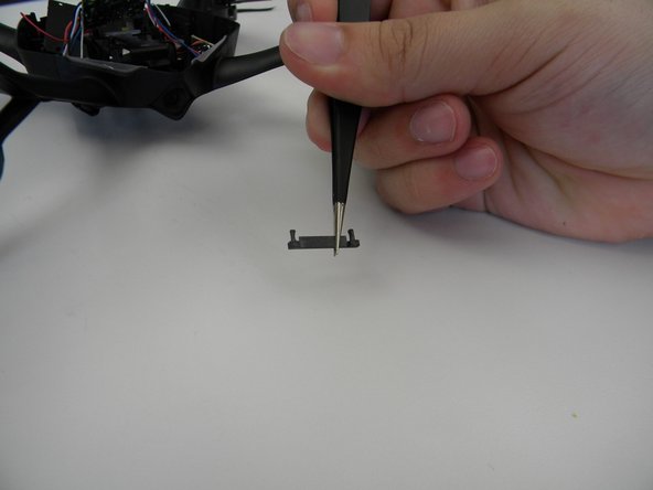

  8. Protocol Dronium III AP Camera Replacement: crwdns2935265:08crwdnd2935265:01crwdnd2935265:02crwdne2935265:0 Protocol Dronium III AP Camera Replacement: crwdns2935265:08crwdnd2935265:02crwdnd2935265:02crwdne2935265:0
    • Remove the plastic holding the ribbon cable connector with the tweezers.
    • Be careful with the ribbon cable, it is easy to damage.

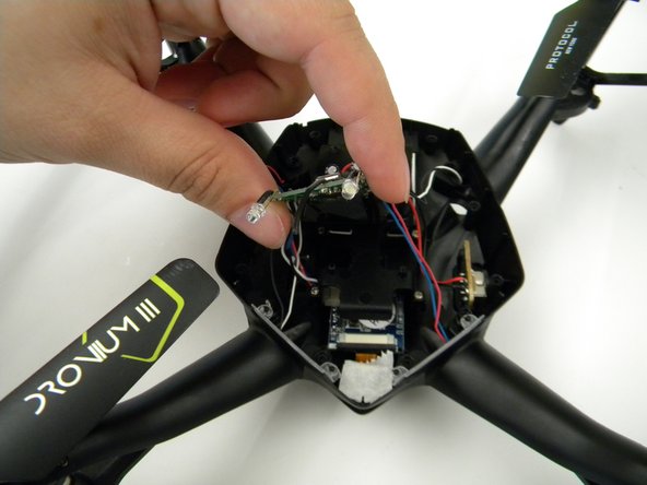

  9. Protocol Dronium III AP Camera Replacement: crwdns2935265:09crwdnd2935265:01crwdnd2935265:01crwdne2935265:0
    • Move the ribbon cable out of the way with the Spuger.

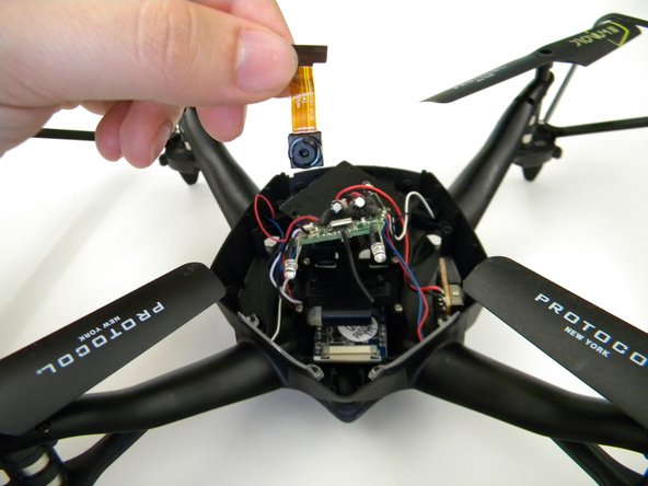

  10. Protocol Dronium III AP Camera Replacement: crwdns2935265:010crwdnd2935265:01crwdnd2935265:02crwdne2935265:0 Protocol Dronium III AP Camera Replacement: crwdns2935265:010crwdnd2935265:02crwdnd2935265:02crwdne2935265:0
    • Remove the camera by gently prying it out of the bracket with the spudger.
