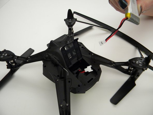

    • Ensure the drone is powered off.
    • Press in and lift battery compartment cover.
    • A soft pry tool may be used for easier access.
  2. Protocol Dronium III AP Battery Pack Replacement: crwdns2935265:02crwdnd2935265:01crwdnd2935265:01crwdne2935265:0
    • Remove battery pack from body of drone.
  3. Protocol Dronium III AP Battery Pack Replacement: crwdns2935265:03crwdnd2935265:01crwdnd2935265:02crwdne2935265:0 Protocol Dronium III AP Battery Pack Replacement: crwdns2935265:03crwdnd2935265:02crwdnd2935265:02crwdne2935265:0
    • Disconnect white connectors between the battery pack and drone.
