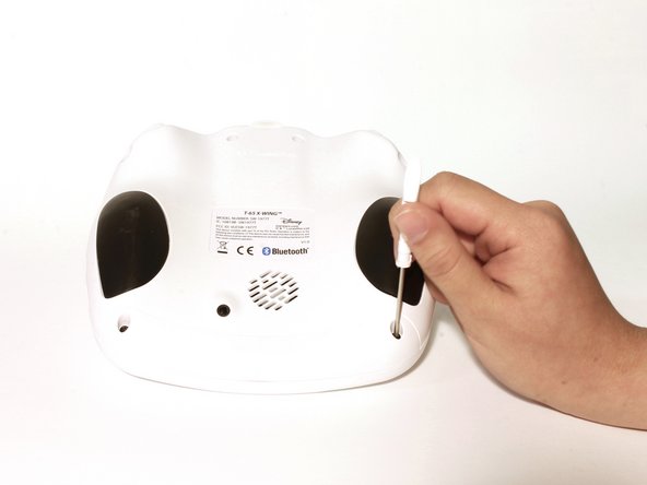

    • On the right side of the controller, slide the small screw driver out.
  2. Propel Star Wars T-65 X-Wing Drone Remote Control Battery Replacement: crwdns2935265:02crwdnd2935265:01crwdnd2935265:01crwdne2935265:0
    • Flip the controller over, so the black panels are facing up.
  3. Propel Star Wars T-65 X-Wing Drone Remote Control Battery Replacement: crwdns2935265:03crwdnd2935265:01crwdnd2935265:02crwdne2935265:0 Propel Star Wars T-65 X-Wing Drone Remote Control Battery Replacement: crwdns2935265:03crwdnd2935265:02crwdnd2935265:02crwdne2935265:0
    • Unscrew the small screw on the left bottom side. The screw should be on the plastic piece that has an upwards facing arrow.
    • Repeat for the screw on the bottom right hand side.
  4. Propel Star Wars T-65 X-Wing Drone Remote Control Battery Replacement: crwdns2935265:04crwdnd2935265:01crwdnd2935265:01crwdne2935265:0
    • Pull the plastic piece off to reveal the compartment where the batteries go.
  5. Propel Star Wars T-65 X-Wing Drone Remote Control Battery Replacement: crwdns2935265:05crwdnd2935265:01crwdnd2935265:01crwdne2935265:0
    • Remove the old batteries.
