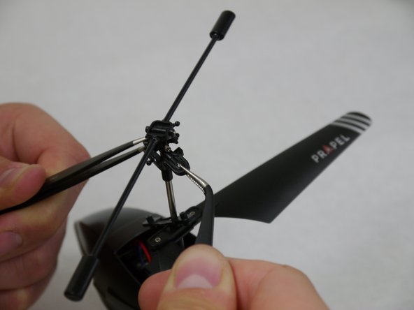

    • Stabilizing links are easy to break. Be gentle when prying them off.
    • Place the tweezers on the sides of the links and pull straight away from the top point of connection.
  2. Propel Gyro-X Stabilizer Replacement: crwdns2935265:02crwdnd2935265:01crwdnd2935265:02crwdne2935265:0 Propel Gyro-X Stabilizer Replacement: crwdns2935265:02crwdnd2935265:02crwdnd2935265:02crwdne2935265:0
    • Remove the two 6.0 mm Phillips #00 screws from the rotors.
  3. Propel Gyro-X Stabilizer Replacement: crwdns2935265:03crwdnd2935265:01crwdnd2935265:02crwdne2935265:0 Propel Gyro-X Stabilizer Replacement: crwdns2935265:03crwdnd2935265:02crwdnd2935265:02crwdne2935265:0
    • Pull the rotors away from the mounting brackets.
  4. Propel Gyro-X Stabilizer Replacement, Stabilizer: crwdns2935265:04crwdnd2935265:01crwdnd2935265:01crwdne2935265:0
    • Remove the two 5mm PHillips #00 screws screws
  5. Propel Gyro-X Stabilizer Replacement: crwdns2935265:05crwdnd2935265:01crwdnd2935265:02crwdne2935265:0 Propel Gyro-X Stabilizer Replacement: crwdns2935265:05crwdnd2935265:02crwdnd2935265:02crwdne2935265:0
    • Using the tweezers twist the rotor attachment bracket apart.
  6. Propel Gyro-X Stabilizer Replacement: crwdns2935265:06crwdnd2935265:01crwdnd2935265:01crwdne2935265:0
    • Remove the two 6mm #00 screws
  7. Propel Gyro-X Stabilizer Replacement: crwdns2935265:07crwdnd2935265:01crwdnd2935265:01crwdne2935265:0
    • Pull up on the stabilizer assembly to remove it completely from the drive shaft.
