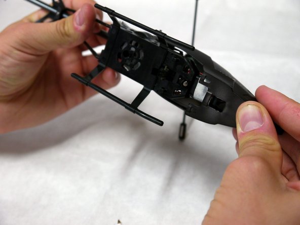

  2. Propel Gyro-X On-Board Battery Pack Replacement, Outer Shell: crwdns2935265:02crwdnd2935265:01crwdnd2935265:01crwdne2935265:0
    • Locate the nubs on either side of the helicopter.
  3. Propel Gyro-X On-Board Battery Pack Replacement: crwdns2935265:03crwdnd2935265:01crwdnd2935265:01crwdne2935265:0
    • Pull the body shell off of the nubs on both sides.
  4. Propel Gyro-X On-Board Battery Pack Replacement: crwdns2935265:04crwdnd2935265:01crwdnd2935265:02crwdne2935265:0 Propel Gyro-X On-Board Battery Pack Replacement: crwdns2935265:04crwdnd2935265:02crwdnd2935265:02crwdne2935265:0
    • Push the front of the nose back towards the tail of the helicopter.
    • Push down on the shell and pull it away from the body, so that both slots pass over the hooks on the bottom of the helicopter.
