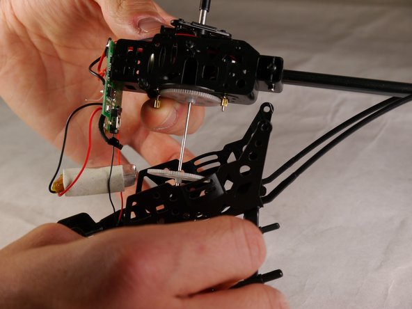

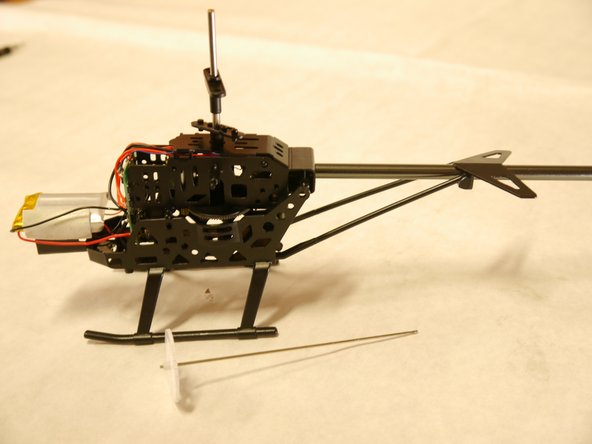

  8. Propel Gyro-X Drive Gears Replacement, Drive Gears: crwdns2935265:08crwdnd2935265:01crwdnd2935265:01crwdne2935265:0
    • Remove the two 8 mm Phillips #00 screws between the motor casing and the body.
  9. Propel Gyro-X Drive Gears Replacement: crwdns2935265:09crwdnd2935265:01crwdnd2935265:01crwdne2935265:0
    • Remove the 4 mm Phillips #00 screw from the tail.
  10. Propel Gyro-X Drive Gears Replacement: crwdns2935265:010crwdnd2935265:01crwdnd2935265:03crwdne2935265:0 Propel Gyro-X Drive Gears Replacement: crwdns2935265:010crwdnd2935265:02crwdnd2935265:03crwdne2935265:0 Propel Gyro-X Drive Gears Replacement: crwdns2935265:010crwdnd2935265:03crwdnd2935265:03crwdne2935265:0
    • Use your fingers to free the motor casing from the body, by bending the plastic body casing outwards at each of the four nubs.
    • Pull the motor casing upwards from the body.
    • The drive gear will slide out when you lift the motor casing.
